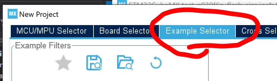

examples for STM32F407G-DISC1
Hello
I just ordered the F4 series board STM32F407G-DISC1. Please let know where I can find the examples codes to work on this board.
I tried to search but couldn't find.
Thanks

https://github.com/STMicroelectronics/STM32CubeF4/tree/master/Projects/STM32F4-Discovery
DISCO ST-LINK/V2,  DISC1 ST-LINK/V2-1 (mBed compatible)

You can use the Example Selector within STM32CubeMX/STM32CubeIDE to load examples.
