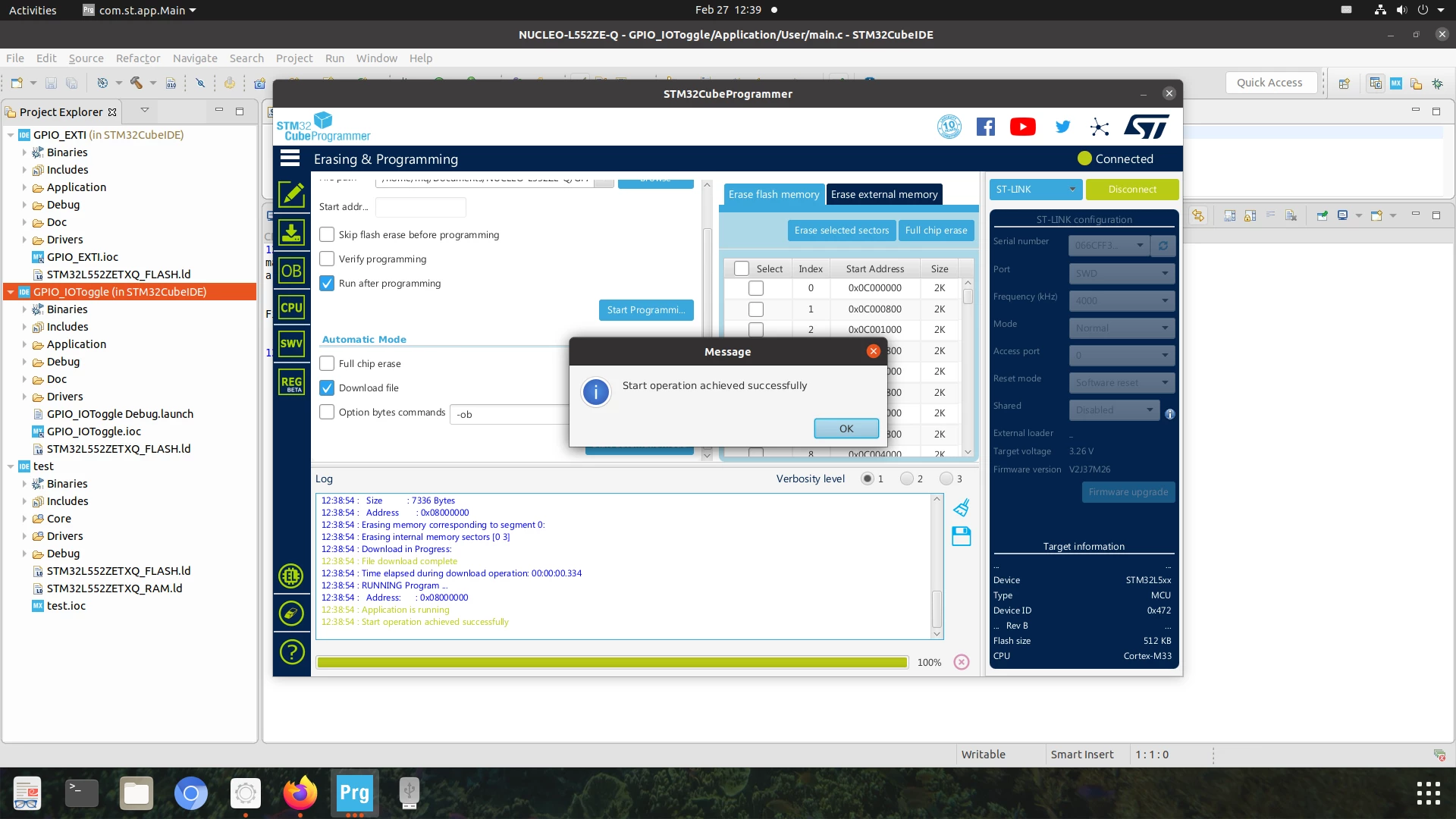

Example project couldn't be loaded into NUCLEO-L552ZE-Q

Error: Data mismatch found at address 0x08000000 (byte = 0xFF instead of 0x00)
Error: Download verification failed
Encountered Error when opening /home/mq/stm32cubeide/plugins/com.st.stm32cube.ide.mcu.externaltools.cubeprogrammer.linux64_1.4.0.202007081208/tools/bin/STM32_Programmer_CLI
Error in STM32CubeProgrammer
Debugger connection lost.
Shutting down...

    Found the solution,since it promoted the STM32CubeProgrammer CLI malfunction, so I programed the .elf file in a isolated Prog tool:

    I guess it was due to I set the "TZEN" enabled, but when I unchecked it in STM32Prog, it was prompted:
     Error: Expected value for Option Byte "TZEN": 0x0, found: 0x1
