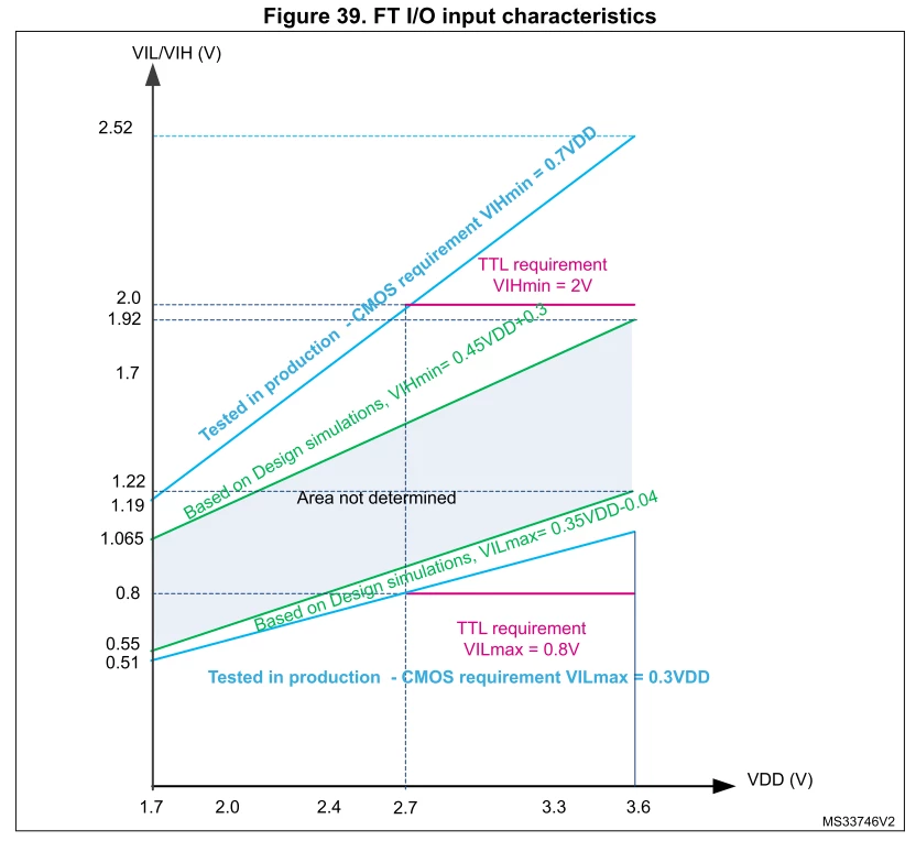

We want to realise a cheap measurement of a external voltage over a voltage divider with a STM32F765ZI processor. We calculate VIL with the formula "0,35*VDD-0,04" which is guaranteed by design. On base of this calulated VIL we calculate our voltage divider, so that at 2,5V external voltage exactly the calculated VIL was at the pin of the µC. But, tested at two pins, the switching level differs from the calculation and also between the two pins:
Pin1:
Low  <=3,115V:
High>= 3,90V
Pin2:
Low<=3,37V
High>=3,59V
Is that a normal behaviour?
So it is not possible to use an input pin with internal Schmitt trigger for a halfway exact input threshold?

0693W000003Qcw7QAC.pngDoes this diagram mean, that the switching point between low and high can be somewhere in the "Area not determined" and differs between the GPIOs of the same µC?
It means they make no guarantees on how it operates in that region. It could vary between pins, between different chips, on the current temperature. If you need a precise reading, use the ADC or (in some devices) the comparator.

I tried more measures directly at the CPU pins without a voltage divider and on more pins. What I can see is, that the hysteresis on most of the pins is only 30mV to 70mV and they toggle extremly. Less of the pins have a hysteresis of about 200 to 270mV and they don`t toggle.
The hysteresis was given as 10% VDD in the datasheet specification. My expectation is, that datasheet parameters will be parameters that the µC will realize. I understand the behaviour in the "Are not determined", but the hysteresis is given as a parameter without tolerance. With a real hysteresis between 30mV and 305mv (with only 20% of the tested pins near 300mV) the darasheet parameter is not fulfilled in my opinion.

Depending on the exact ground and power tracks layout, the power supply, surrounding circuitry and their activity, and the internal and external activity of the mcu itself, there is noise on the power versus ground pins. This is usually dominated by switching noise from inside the mcu. 10s or even a few 100s of mV are no surprise. Also there are voltage differences - across the whole frequency spectrum including DC - between the individual ground pins.
Welcome to the world of digital electronics, where it meets analog and HF.
