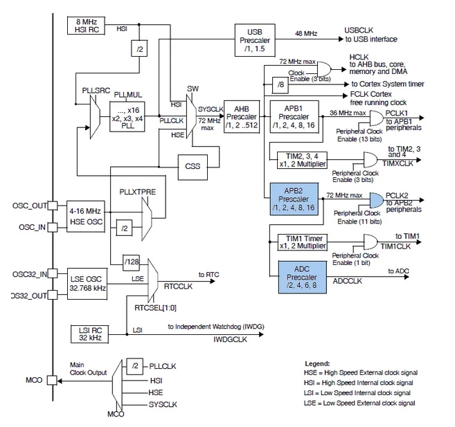

Resolved:
For mode Compare Output is absolutely necessary the value for Period(for HAL library) equal to 65535(filled registry of 32 bits)
View the schematic:

Resolved:
View the schematic:
