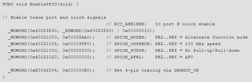

I am using STM3210C EVAL board (stm32f107vc). UlinkPro debugger.
Here is the tutorial I found from keil.com.
http://www.keil.com/support/man/docs/ulinkpro/ulinkpro_stm32f10xxx_etm.htm
Here is the snipping.
So, when we need to using ETM trace, we just need to enable the Trace PORTs clock, and configure them as AFIO with highest speed, then set the DBGMCU_CR, that's it?

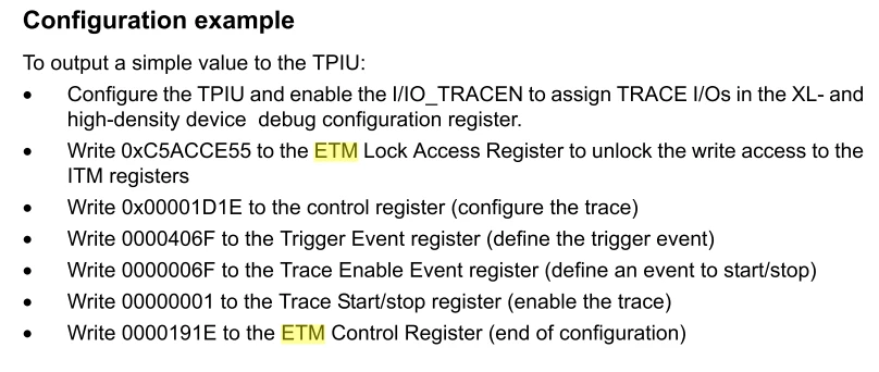

What I found in the STM32F107 user manual is this!
it looks different!

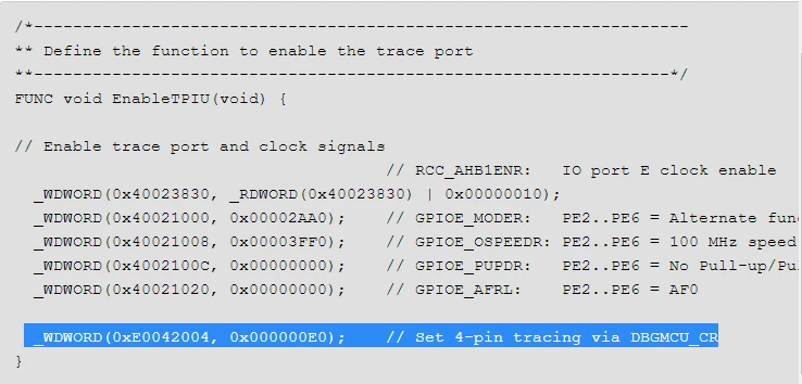

1)  The code you display for the .ini file is to set the Trace Port GPIO pins to handle ETM the best.
2) The code you show from the ST manual is something different - this configures ETM inside the CoreSight module in the STM32.

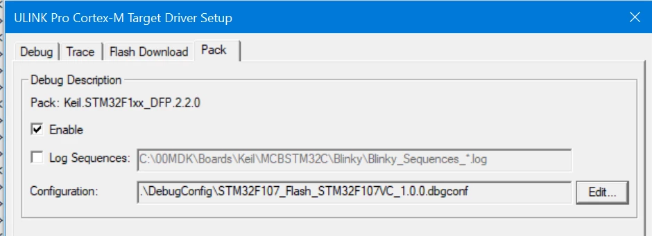

2) In the latest Software Pack - there is a new entry - in the Target Driver Setup window there is sometimes a new tab:  Pack.  See below.  This can contain a file dbgconf as shown below.  This is used instead of the .ini file in the older way.

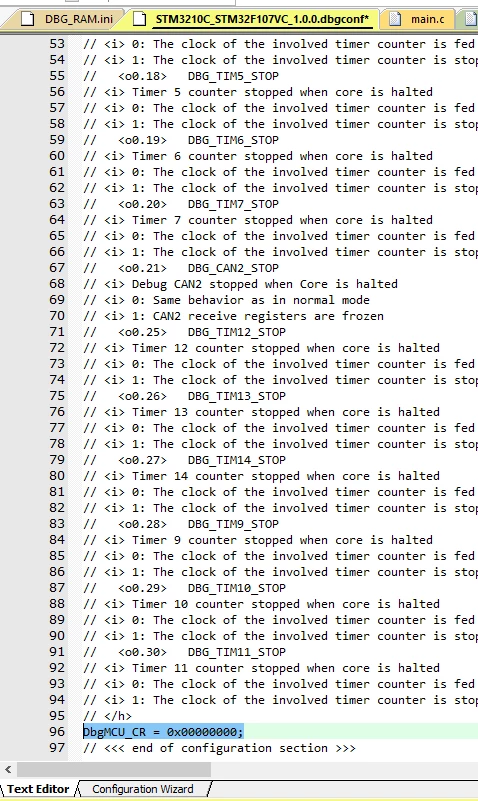

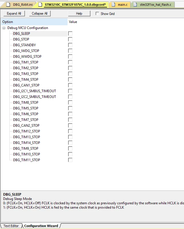

In the pack. I found this.
In my case, I will leave all unchecked.
Then I look in the Text Editor.
DbgMCU_CR = 0x00000000; !!!
What is the pack doing?!!!
Maybe I can see the register
who will run first
But this really get people confusing.
if
.dbgconf first, the finally
DbgMCU_CR  will be rewrite to 0x000000E0. That is ok.
But if my *.ini file (Project - options - debug ) run first, DbgMCU_CR  = 0;
there are 2 ways for us to configure the ETM tracing ?

2) the dbgconf file located in the Pack. This can be disabled.
3) Since CoreSight information is public - you can enable it in your source code as you saw in the ST document.
I suppose you can set a Watchpoint to the address of
DbgMCU_CR
and the user program will stop when this is written to exposing the instruction doing this - or at least very close.
