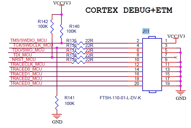

hi,
i am using stm32f7 and for debugging ulink pro, i have tried to enable ETM but not succedded. the connector i am using is, where traceD0-D3 are PE3-PE6. 0690X000006052bQAA.png the *ini file i used is

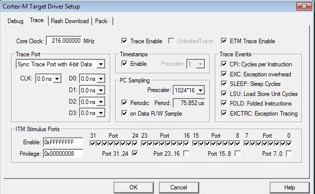

the debug settings i have also attached 0690X00000605MLQAY.png but the performance window displays 0 calls 0 time 0% cpu usage. thank you in advance for any help. Bilal

    Greetings
    I recently also struggled with this. With the uLinkPro I found adding a 2.6ns delay to CLK got it working most of the time. I did not use any ini configuration file. It worked without that.
    The Segger J-Trace Pro in Ozone worked without any problems whatsoever.
