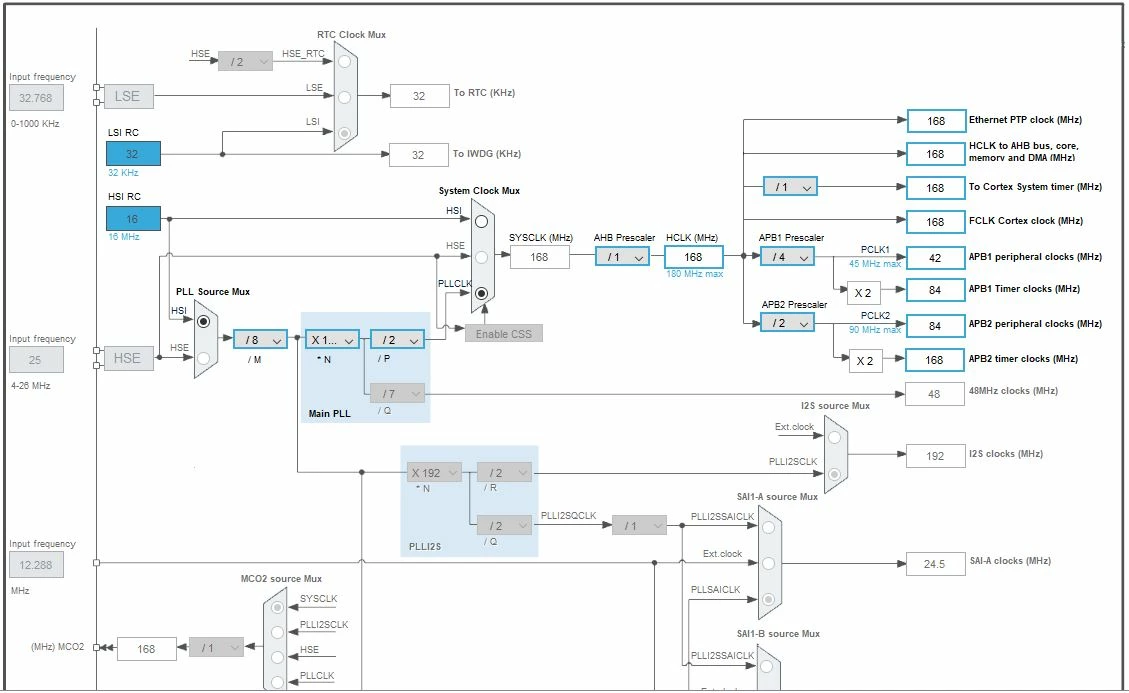

I have a custom designed board using a STM32F429IET6 and LAN8742A.
While attempting to bring-up ethernet and LWIP (fails w/o LWIP at the same spot) the code continuously fails in stm32f4xx_hal_eth.c in `HAL_ETH_Init` while waiting for the SW reset to complete after setting the SR bit in the DMABMR register.
I've attempted copying as closely as possible the development board design (Nucleo-F429ZI) in software. The only differences that I can see are:
- We use PG14 for RMII TXD0 instead of PB13.
- We are using a 25MHZ external clock instead of the 8MHZ the Nucleo-F429ZI uses, but both running the board HCLK @ 168MHZ.
- We use a dedicated reset line from the MCU PA6 to the nRST line on the LAN8742.
- The Nucleo has the RXER pin going through a 10k then to GND. We also have a 10k to GND but it also ties to PB10. Currently, we have the PB10 pin not setup.
This is where the timeout is happening in stm32f4xx_hal_eth.c (see line 15 of this snippet):

 Below is a screenshot of the clock configuration:
When we probe the ETH_REF_CLK we see the line go high, clock for a small amount of time at the wrong frequency (~1.25khz) and then remain high afterwards.

The software reset does not autoclear if the ETH input clock is missing. You've already confirmed this is the case:
so now find out, why. If you have arranged LAN8742A to have its own 25MHz crystal, make sure it oscillates, and then also make sure you have installed the appropriate strap option (IIRC RXER/PHYAD0 pulldown, but double-check it in the LAN8742A) to enable the clock doubler in LAN8742. Also make sure the RMII_REF_CLK input pin (PA1) is properly connected, properly configured in GPIO, and check that SYSCFG_PMC.MII_RMII_SEL is properly set for RMII.
