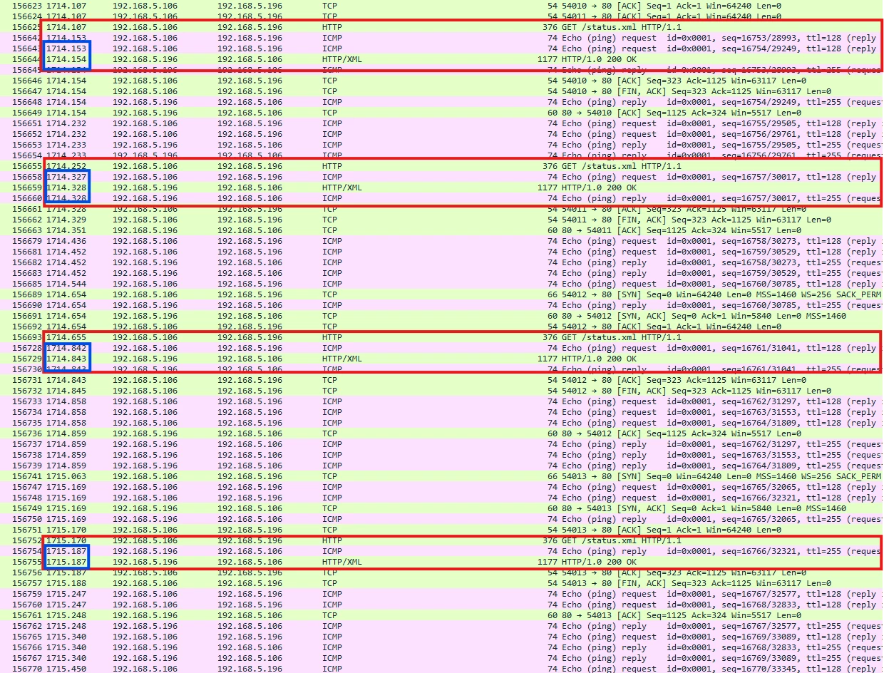

I'm running an STM32F767Zi on a custom board, LwIP 2.1.2, no OS. The device acts as a HTTP server. I've got an issue where I get GET requests and [FIN, ACK] packets retransmitted by the web browser.
192.168.5.106 - Client
192.168.5.196 - Server
The issue seems to be intermittent and appears only when a portion of the webpage content is requested (status.xml) once per second. When the entire webpage content is first loaded I don't get any packets retransmitted.
The pattern is:
  1. GET / [FIN, ACK] packet
  2. retransmission after 200 - 500 ms
  3. response immediately after (2)
  4. Dup ACK immediately after (3)
Looks like the first GET request is not processed until the retransmitted packet arrives.

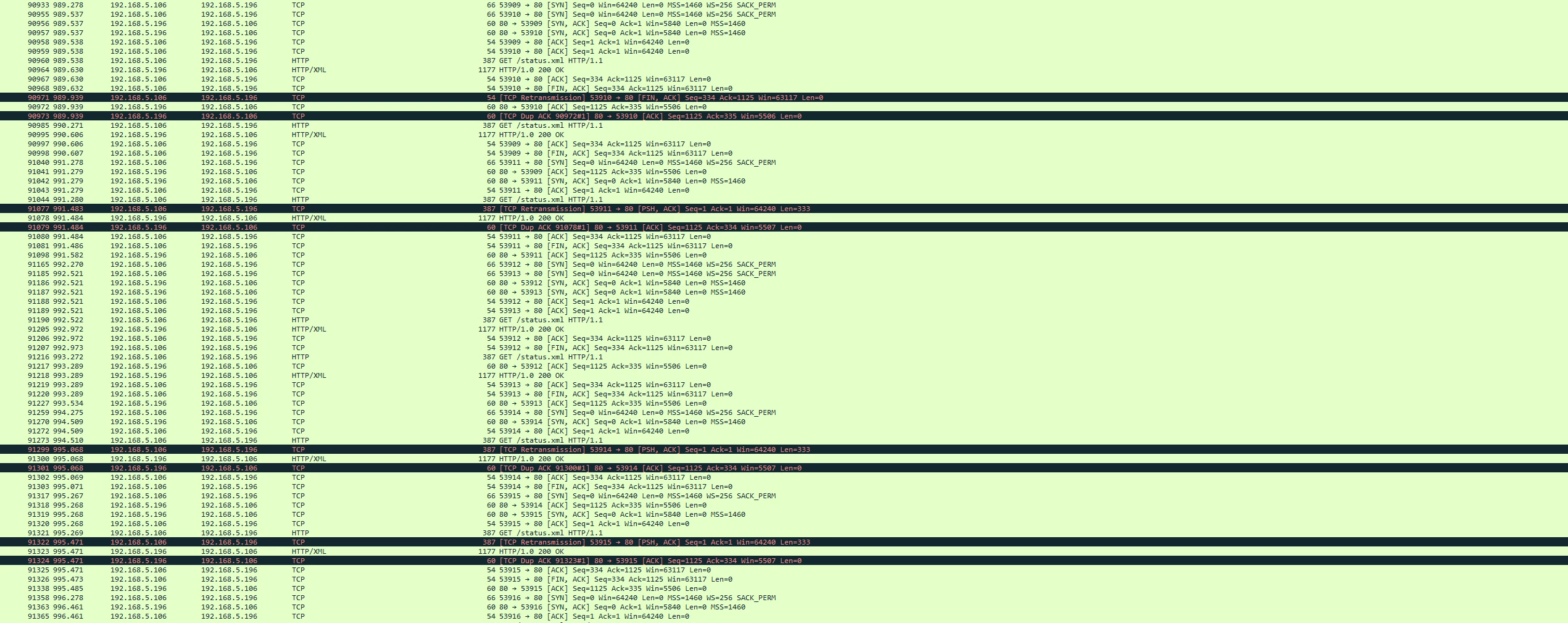

I noticed that the problem goes away when I disable LCACHE by resetting IC bit in SCB_CCR. Also, GET message processing time increases from 8-9 ms to 16-17ms.
EDIT2:
I made another observation. I flooded the device with ICMP requests simultaneously from 8 terminals. If an ICMP packet arrives after a GET request, I get the correct response from the HTTP  server and the GET packet doesn't get retransmitted.
