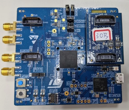

Thanks for sharing of the link! It seem that we need to try the APS6408L-3OBM-BA to see if it works. It may wait until next version of our prototype board to add it on, because I couldn't find any evaluation board of this BGA.

I'm not sure which board you are looking at. For reference, we did test APS6408L-3OBM-BA  on MB1331 for STM32H7A/B, by replacing the NOR to IoT RAM using the OCTOSPI2 slot. Demo code attached as well.
Thanks
Alex

Please see APS6408L-3OBM-BA code example attached, It was used on MB1331 STM32H7A/B board, replacing the NOR by our RAM on the OCTOSPI2 slot
Hope this help
Alex

Thanks for description and the sample code! I really appreciate it. We are going to produce a new version of prototype board for one of our new products and I will add APS6408L-3OBM-BA on it to test.
What I meant by evaluation board was that if APM had small PCBs with APS6408L-3OBM-BA like in your picture. It would help people to verify the memory with their designs and APM to sell more memory.
