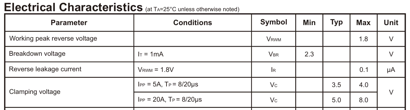

> What do people use to, say, protect SWD lines on an MCU whose Vdd rail is 1.8V?
There are plenty of ESD diodes intended for 1.8 V applications. You will find the clamping voltage to be significantly above 1.8 V. Here is one at random:
These are not on/off devices, but gradually turn on when voltage increases. The clamping voltage should not be read as "the voltage will never get above this". The diode lets more and more current through as the voltage increases.
They're devices for mitigation and they do a good job, but they are not perfect protection. Zap the device enough times and it will die. Imagine lightning hitting your house repeatedly. It's a high-energy event. Even with the best electrical prevention, eventually it'll damage something. (Not a perfect analogy, but a good one.)

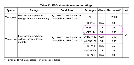

> For example, the datasheet for the stm32u59xx has an Absolute Maximum Ratings table that shows most FT (5V tolerant) pins have a max rating of either 5.5V
This is for DC voltage values. For an ESD event, the "ESD absolute maximum ratings" table is the more relevant value. Pins are typically rated to 2 kV events. Adding an ESD diode increases that dramatically. The pins will generally see more than the "absolute max" dc voltage value during such events if they're connected directly.

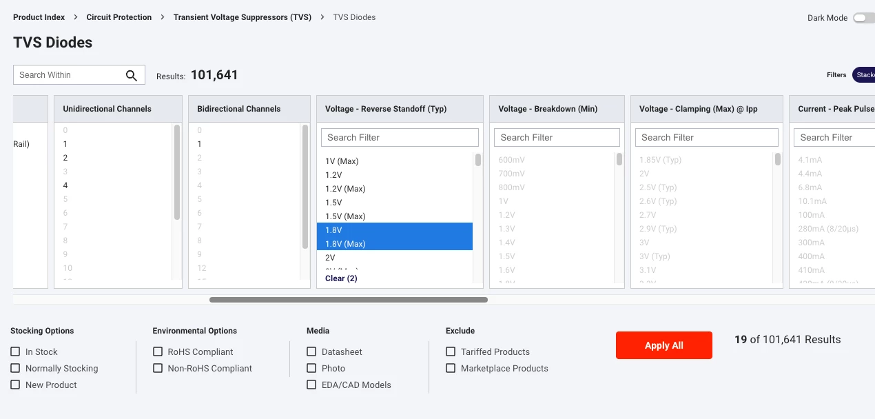

So - I feel silly asking this - how did you do this, exactly? For example, when I go to Digikey, and go to Circuit Protection->TVS->TVS Diodes, and I select 1.8V Reverse Standoff Voltage in the parametric settings, I see:
 Of the 19 results, only 6 are even stocked, and none show the specs you highlight in your screengrab.
Further, if I go here to ST's site, and I visit either the ESD Protection page, or the TVS page, there are no products listed with a Vrwm of 1.8V (again, I'm just trying to replicate what you seem to be showing).
I have this experience over and over and over again - TI's site, Nexperia, etc. etc., I try filtering by products that have a Vrwm of 1.8V (no other filtering), and come up with - at best - a single product, or - usually - no products. But I think "ST makes heaps of products for ESD, and they make heaps of MCUs that run at 1.8V! Why is there this apparent disconnect?!". I'm quite sure - given that you say there are "plenty" of these kinds of parts - that I must be doing something horribly wrong in my searching, because I'm totally unable to find "plenty" of options. The best I have ever found is this one, single product that indeed shows a Vrwm of 1.8v and a clamping of around 4V. But boxing myself into relying on a single product is terrifying, and I'm fairly sure the entire 1.8V world isn't relying on this one single diode.
Ah, ok this is a wonderfully helpful clue! So here is that table for the stm32u5:
I've read AN1709 and AN5612 several times over, to try to understand the various jargon/terminology often used to describe various ESD protections (JEDEC vs IEC 61000-4-2, HBM vs CDM vs air discharge vs contact discharge), and admit my grasp on all of it is tenuous at best. What, for example, would lead me to conclude from the above table that the figure I should be paying more attention to is the 2kV HBM value you mentioned, and not the 250V CDM value? And do I understand you to be saying that if I can find any ESD protection device that clamps below 250V, that would generally be sufficient for my application (regardless of whether my MCU is running at 1.8V or 3.3V, no less)?
My understanding is that that JEDEC standards seem to refer mostly to handling the individual component (the MCU in this case) in the factory during manufacturing/assembly, whereas IEC 61000-4-2 refers more to the system as a whole, as it is being operated after assembly (therefore, more relevant to "human walking across a carpet and picking up my device). But I may be mistaken about all of this (clearly I can't even do a parts search, so I'm not to be trusted much here), and am still finding it confusing.
If your intention is to shield the device from humans applying the shock after shuffling their feet on carpet, or whatever, then HBM is most appropriate as it most accurately mimics the type of shock that is applied. There's not a fixed equivalence between them. You shouldn't think "2 kV HBM" is more or less protective than "250 V CDM". But there's certainly a correlation.
