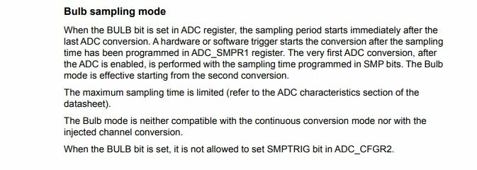

ES0430 In 2.7.2 ADC input channel switching disturbs ongoing conversions talks about "bulb sampling". Is "bulk sampling is meant?

Hello @Uwe Bonnes​ ,
It's "Bulb sampling mode" as described in the ADC section in the RM0440 reference manual.
