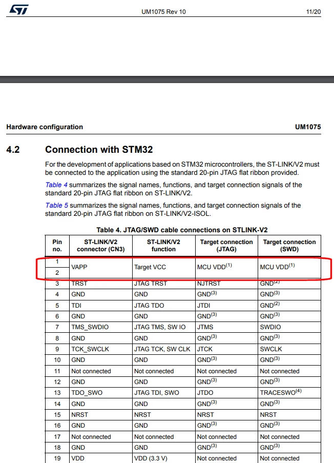

Error: target voltage may be too low for reliable debugging

@Shubh150 wrote:
could this be an issue of my code?
No: The ST-Link measures the Target supply voltage on its VAPP pin:
It's a hardware measurement - not a software thing.
So check that you have this connected correctly.
Check the actual voltage using a meter.

Thank you for your reply, I have not connected the VAPP pin anywhere on my board. I have only connected VDD, GND, SWCLK and SWDIO.
Should I also connect the VAPP pin to my board.....if so then where?
