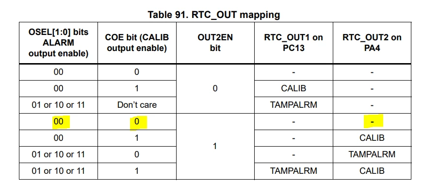

In this case, configuring GPIOs (PA4, PC13) as alternate functions is the same as configuring GPIO in output mode, this note in the ref man (and the Cube examples) is there so users won't configure GPIO as input or analog...
>>The effect of RTC on PA4 operation stopped when I changed the contents of the RTC_CR_OSEL field to 00
Please correct me if I'm wrong, but you're talking about this case?

>>...this note in the ref man (and the Cube examples) is there...
Please point out where in the reference manual this is mentioned. Or provide a quote.
For the case you indicated in yellow in the table, GPIO works correctly, PA4 is controlled by GPIOA->ODR.
Incorrect operation of GPIO PA4 is observed when the field RTC_CR_OSEL=11, RTC_CR_OUT2EN=0 and RTC_CR_COE=0.
In this case, PA4 should work as a GPIO, but in fact some signal from the RTC goes there.
At the same time, there is a strange voltage level of 1.9 volts at pin PA4. (Controller power supply is 3.3 volts.)

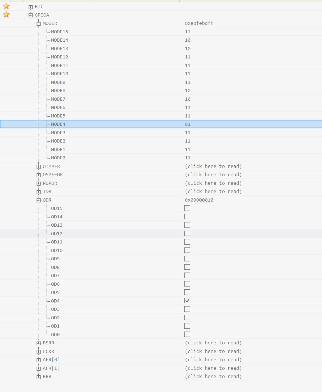

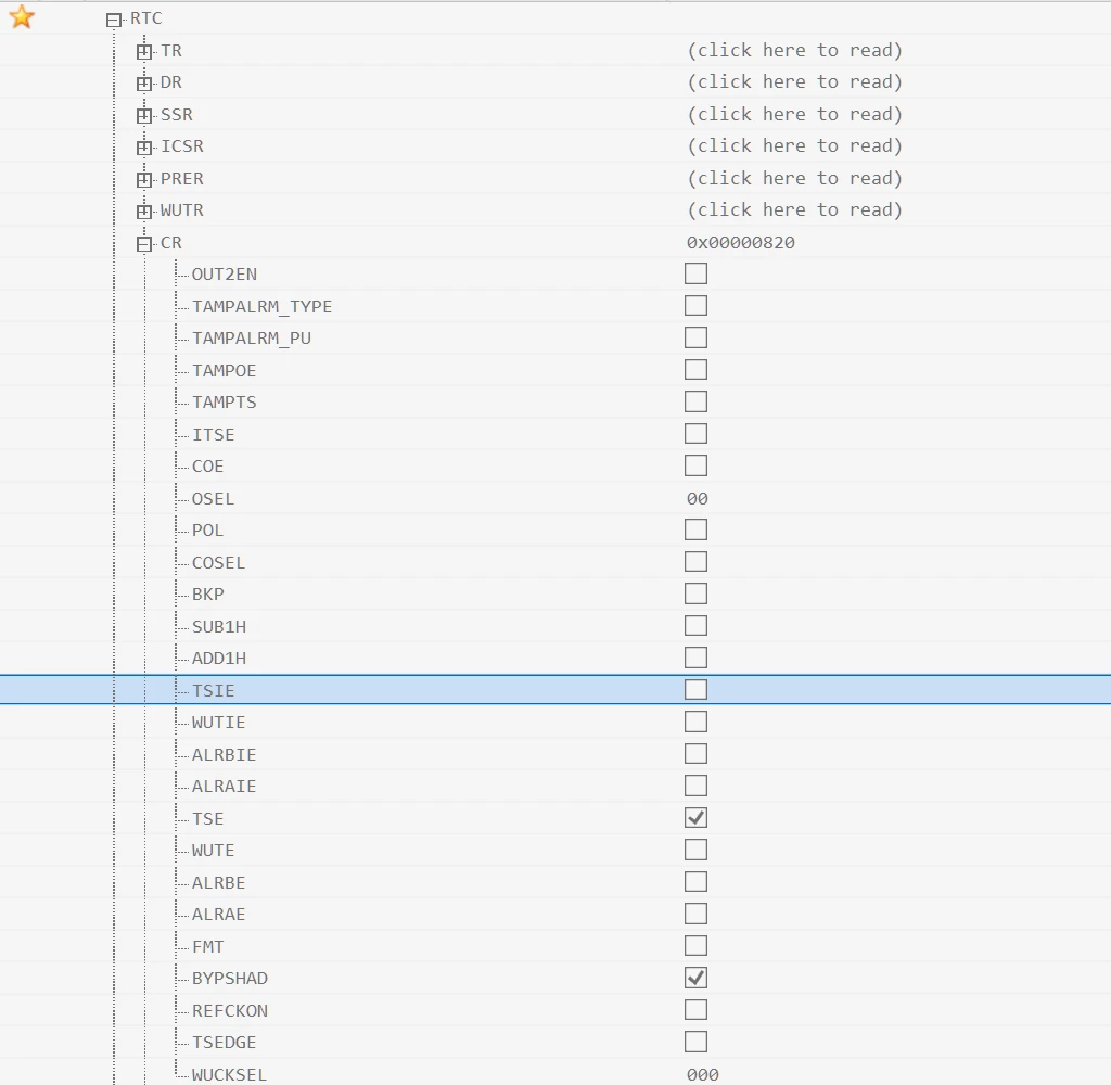

Issue description:
I'm experiencing an unexpected behavior with PA4 pin on STM32G030F6P6. While PA4 is properly configured as output (in GPIO mode) and ODR register is set to 1, the pin doesn't function as expected when RTC peripheral is configured.
Configuration details:
- PA4 is configured as GPIO output
- ODR register has bit 4 set to 1
- RTC CR register settings:
* RTC_CR_OSEL = 00
* RTC_CR_OUT2EN = 0
* RTC_CR_COE = 0
Current behavior:
1. On power reset, PA4 works correctly as GPIO
2. After RTC peripheral configuration (RTC_OUT2EN disabled), PA4 stops working as output
3. Pin works fine when configured as input.
Issue like this must be in errata, for sure.
Are there any workarounds to maintain PA4 GPIO output functionality while RTC is enabled?
eos1d3
November 1, 2024
This is perfectly normal behavior. Since it is related to RTC domain, you have to explicitly disable it with your code if you enabled some settings of RTC before. The second method is to power off the MCU and start it again.
All settings for RTC domain behave like this. And this is not an errata.
