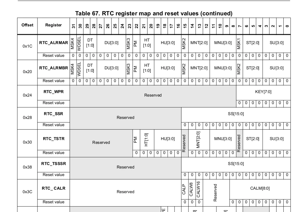

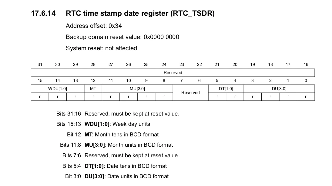

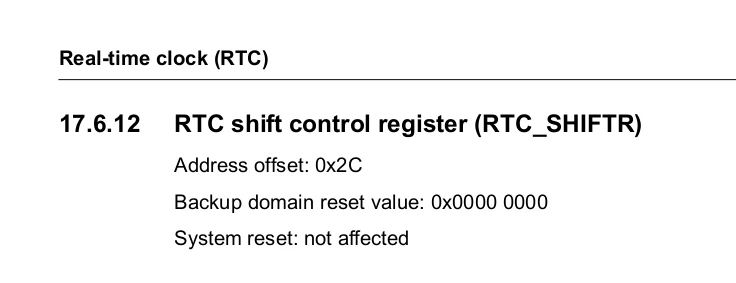

I'd just like to report an error on the reference manual for RMSTM32F411 (RM 0383 Rev 3).
The error is located on page 471, on section RTC Register Map.
The table showcase all registers for the RCC and miss the entry for RTC_SHIFTR (located at address offset 0x2C) and also for RTC_TSDR (located at address offset 0x34).
Screenshot from 2025-04-07 18-20-31.pngScreenshot from 2025-04-07 18-22-21.png
Here, 0x2C and 0x34 are missing from the register map.
