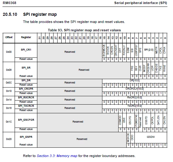

Error in RM0368 Reference manual, SPI Register Map is missing SPI_CR2 register
I noticed in the document RM0368 (Rev 6) for F401RE the SPI Register map (Table 93 page 611) is missing the SPI_CR2 register.

This topic was about Rev 5, and the problem should have been fixed in Rev 6.
Is my Rev 6 a too old document and it was patched in later revisions or is it still in the latest revisions as it appears that REV 6 is the latest version of RM0368 according to the F401RE product page :

Hello @MattGEII and welcome to the community;
I confirm that rev6 is the latest revision of RM0368. Unfortunately the reported issue isn't yet fixed. I tracked it internally (210034) and I'll make sure to fix it.
Internal ticket number: 210034 (This is an internal tracking number and is not accessible or usable by customers)
Thank you.
