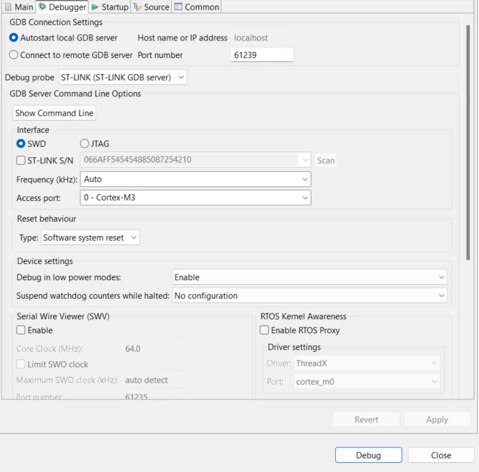

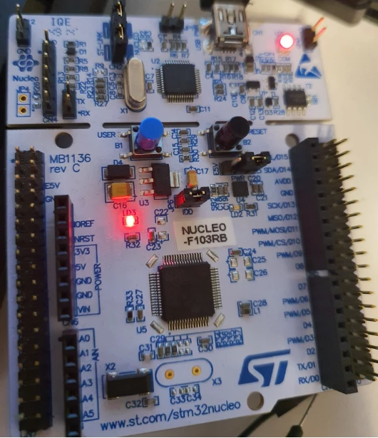

I am using a nucleo-F103RB. This device was functional in the past.
I am getting an error
Error in final launch sequence:
Failed to execute MI command:
target remote localhost:61239
Error message from debugger back end:
localhost:61239: Connection timed out.
 I have tried different cables to ensure it isn't the issue. I have also changed the port number.
This is my debugger information:

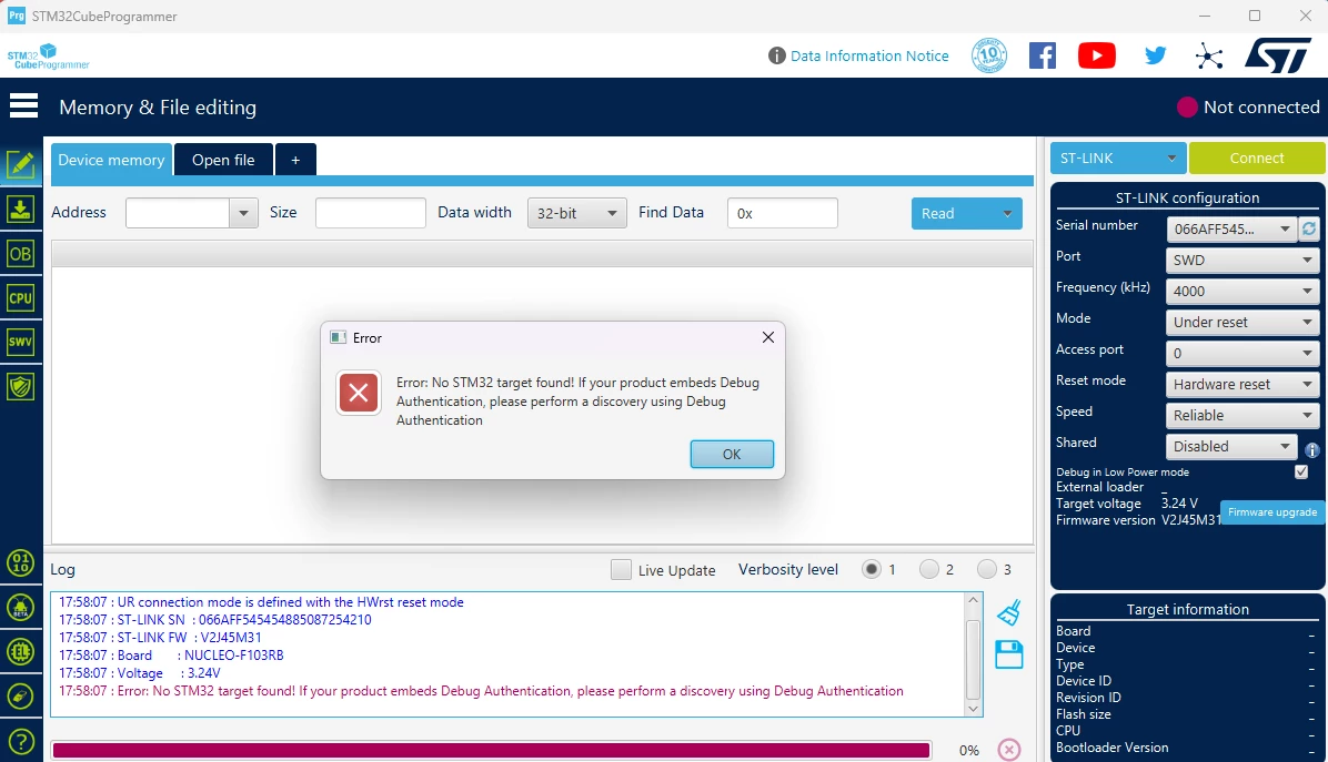

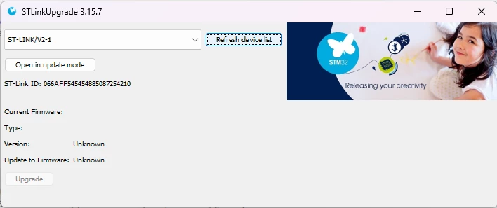

I am able to upgrade my stlink chip via cube ide as shown in the image below (it detects it)

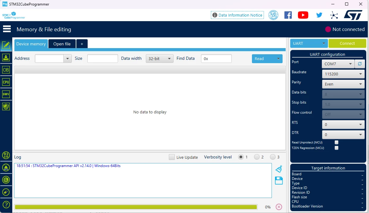

I have tried to use the stm32cubeprogrammer application too but that doesn't seem to work.
I get the below error.

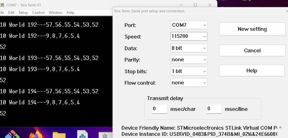

However i know it is working on COM7 because the last thing i did was create a program to output some information through the USART, which it is still doing (image below).

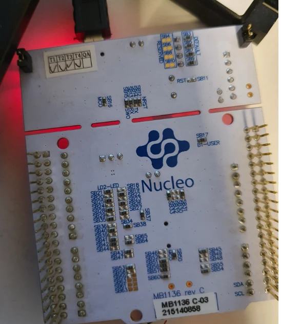

I have also attached images of my board.

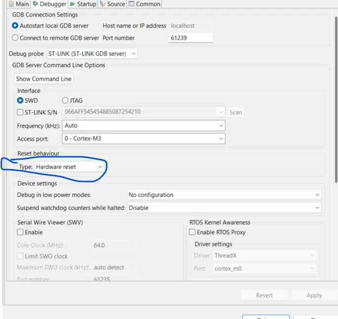

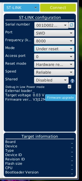

Maybe you did something, to block the swd , not defined degub in Cube, use swd pins for something else...
to get access :
set debug to hardware reset;
try. If not connect in IDE :
or in cubeProgrammer : set st-link, hardware reset, connect under reset.
Then full erase , to get away the "problem" program.
October 5, 2024
Is this what you mean?
I have changed the option to this and i still get the same error

ok,
so check: boot0 lo ?
And try - as i wrote -
in CubeProgrammer : set st-link, hardware reset, connect under reset.
show, what cubeprog telling:
If no connection with CubeProg or IDE possible, last chance:
set boot0 hi , reset or power cycle, and connect to bootloader .
If connection not working at all:
- some connection (wire) not there, check jumpers for swd/swc , connect st-link to cpu  really ?
- you damaged cpu, need a new board, or replace cpu.

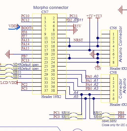

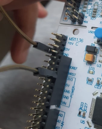

I have connected boot0 to high and and then tried to use stmcube to try and see if i can detect it. However i am getting the same issue (image below)
below is an image of boot0 being high.
AScha.3
October 8, 2024
You cannot connect to bootloader this way !
still missing info:
>after i had connected pin 5 and pin 6 jumper.
Leave this jumper away ! It cannot work with connected pin 5 and pin 6 .
+ -> show, what cubeprog telling ...now.
October 8, 2024
That is how you get into boot loader mode. You can see from the circuit diagram pin 7  on the CN7 connector, the boot pin and i am pulling it high to 3.3V.
