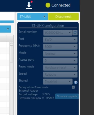

If you're using a knock-off programmer, note that it might just not work, especially with STM32CubeIDE. Use STM32CubeProgrammer until you can "connect" successfully--it is typically more robust.
AScha.3
Feb 24, 2025 7:59 PM UTC
...and if your st-link is a stick (= clone), set connect : software reset (the "stick" has no reset output!)
And try with CubeProgrammer first (more tolerant with clones...).

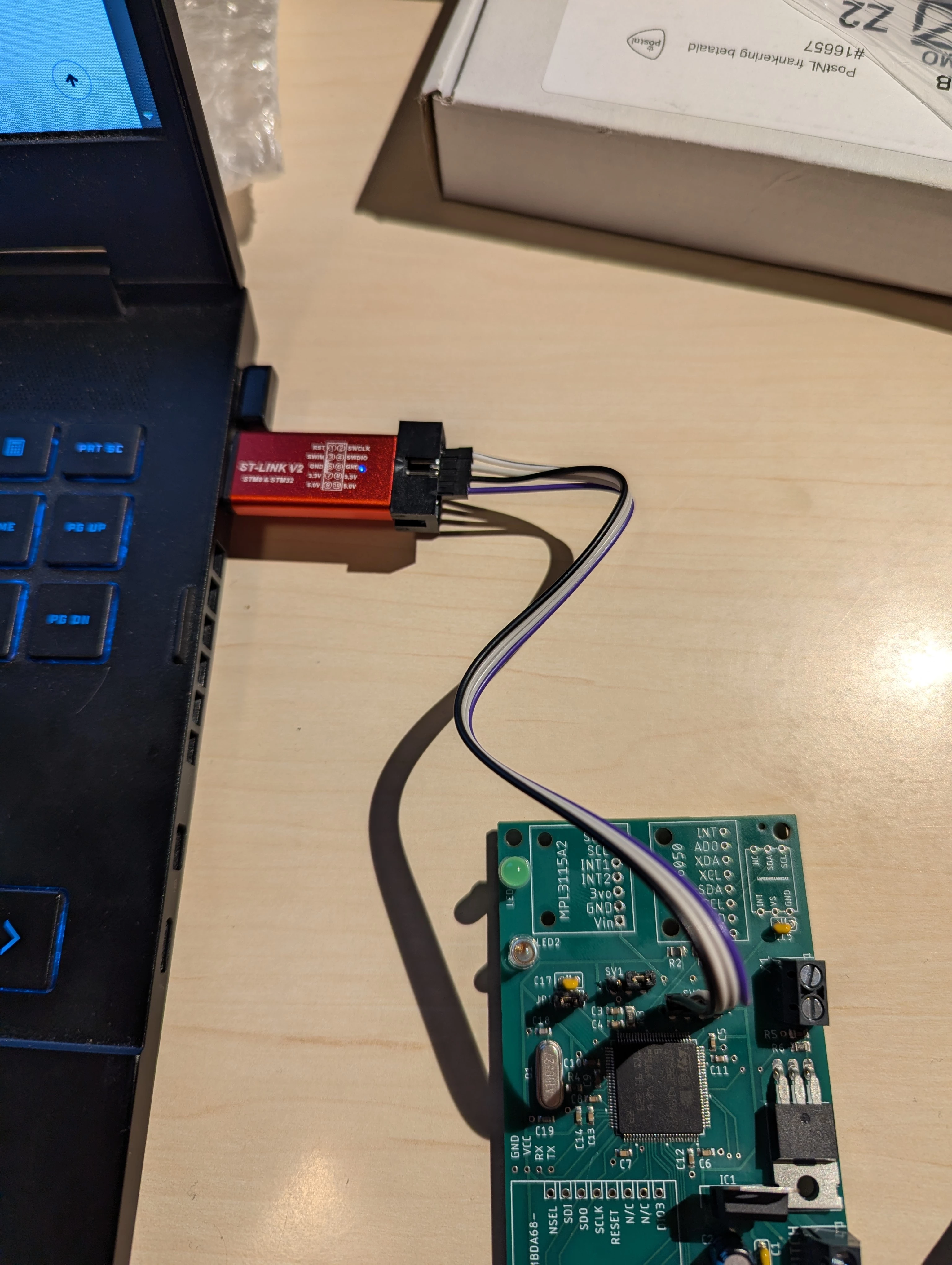

Feb 24, 2025 8:40 PM UTC
This is the st-link that I am using and how it is wired:
I'm unable to find the setting you mentioned.
Could you please provide more details?

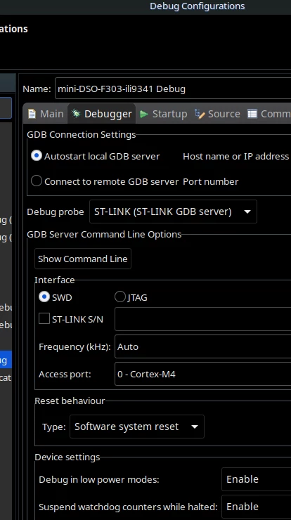

in Cubeprogrammer:
reset mode -> software
in IDE -> debug configuration -> same...
