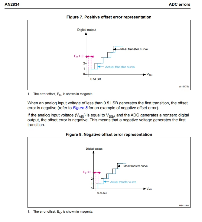

Hello ST people,
I spotted an error in AN2834 rev 9, figure 8. Please refer to the image attached.
A negative offset error should be depicted in figure 8, but it is a positive offset error, just like in figure 7. To be a negative offset error, the actual transfer curve has to be offset to the left of the ideal transfer curve.

Hello @ke1wa and welcome to the ST Community :smiling_face_with_smiling_eyes:
Thank you for reporting this. I've escalated to the Concerned team for more investigation and correction (under internal ticket number 184479). Thanks again for your contribution.
