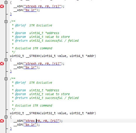

I get big trouble witch IAR work bench arm 9.60.3.

Hello @KhoiNguyen
It seems this is related to the Arm.
Note that specifying the same register producing unpredictable results.
Please check the arm documentation.
