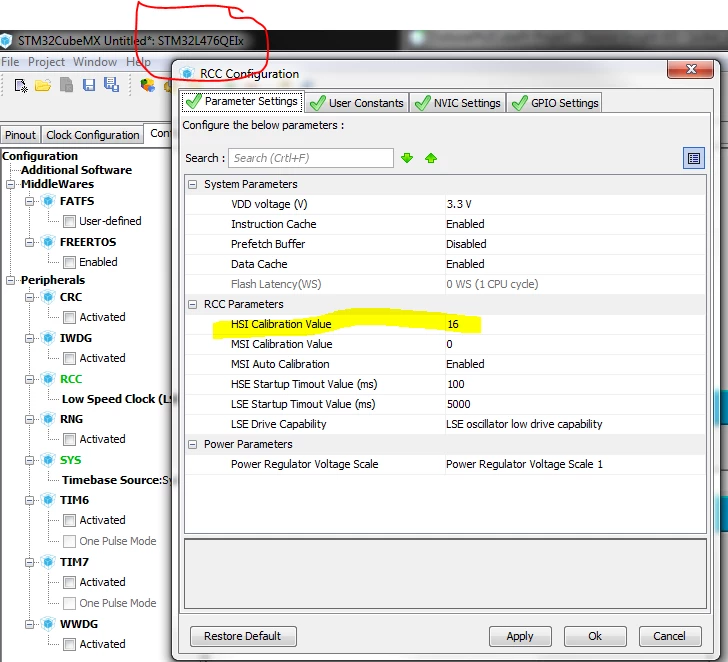

I found this by mistake.
I posted a problem waking up from Stop Mode 2 via LPUART
https://community.st.com/0D50X00009XkfHjSAJ
The problem started when I used CubeMX generated code to use 80Mhz system clock instead of the HSI, while HSI stayed the LPUART clock.
The CubeMX generated the following line:
LL_RCC_HSI_SetCalibTrimming(16);
This is consistent with the datasheet that states:
Bits 30:24 HSITRIM[6:0]: HSI16 clock trimming (only HSITRIM[4:0] on STM32L475xx/476xx/486xx
devices)
These bits provide an additional user-programmable trimming value that is added to the
HSICAL[7:0] bits. It can be programmed to adjust to variations in voltage and temperature
that influence the frequency of the HSI16.
The default value is 16, which, when added to the HSICAL value, should trim the HSI16 to
16 MHz ± 1 %.

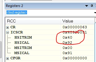

Once I masked this line the code functioned properly (when this line wasn't masked I got frame errors in the LPUART), and looking at HSITRIM I see the actual default value is 0x40.
#stm32l4 #trim #lpuart #hsi

Hello
Ofri.Igal
I checked that RCC_HSICALIBRATION_DEFAULT value is correct in the STM32CubeL4 with the default value 0x
I already raised this issue internally to correct
the reference manual with the number of bits containing HSITRIM[6:0] for the
default value set to 0x
Best Regards
Imen

I started a new project using CubeMX Version 4.24.0
The project was for STM32L476QE, the default value is still 16.
Feb 14, 2018 10:15 AM UTC
Posted on February 14, 2018 at 10:15
Hello
Ofri.Igal
You are right, I checked that
the default value is not correct
with
CubeMX Version 4.0 and
I raised this internally to CubeMx team for fix.
Thank you for highlighting this issue, and Sorry for the inconvenience it may bring.
