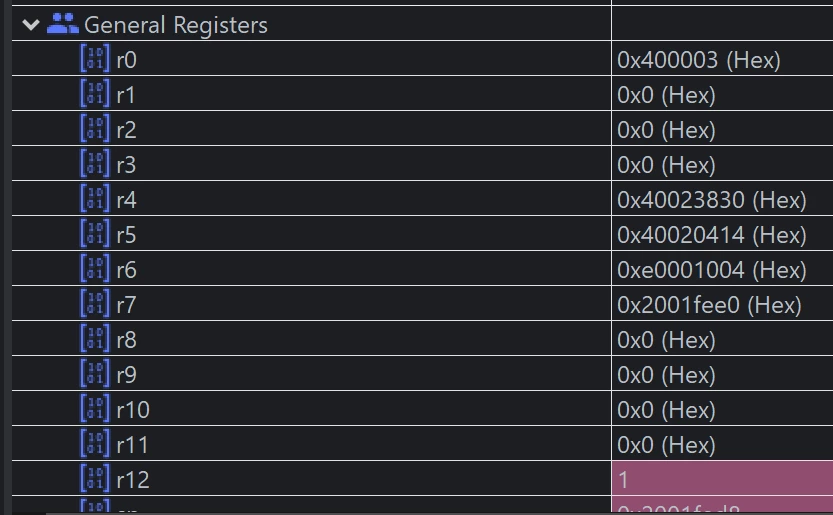

@waclawek.jan FWIW, I can't quite duplicate this on a STM32F411 with max clock (this particular chip errata is the same). I tested GPIO->ODR, CRC->DR and TIM2->ARR. Only GPIO and CRC needed a delay, and a delay of 1 NOP or 1 read from either register worked. TIM2 matched your results (no delay needed). I even used maxed AHB/APB prescalers which made no difference in the results (despite what errata suggests).
Ticks were the difference in DWT->CYCCNT before/after the stores and loads.

Example code where READ_ENABLE=1:
08002aa8: ldr r2, [r6, #0] start = DWT->CYCCNT;
08002aaa: str r0, [r4, #0] RCC->AHB1ENR |= RCC_AHB1ENR_GPIOBEN;
08002aac: ldr r1, [r4, #0] [r1] = RCC->AHB1ENR
08002aae: str.w r12, [r5] GPIOB->ODR = 1;
08002ab2: ldr r3, [r6, #0] end = DWT->CYCCNT;
08002ab4: ldr r1, [r5, #0] result = GPIOB->ODR;
 Registers at start of that code:
96 MHz clock, prefetch enabled, data cache enabled, instruction cache enabled.

[00.005328] Results for GPIOB->ODR:
[00.009487] ticks=6, result=0, FAILED <-----
[00.013657] ticks=9, DSB=1, result=1, pass
[00.017846] ticks=7, READ_ENABLE=1, result=1, pass
[00.022039] ticks=7, READ_PERIPH=1, result=1, pass
[00.026234] ticks=6, NOP=1, result=0, FAILED <-----
[00.030408] ticks=8, NOP=2, result=1, pass

There is an another topic about these issues. By the way, the document Jan talks about, is now ES0182 - Rev 14 and the section is "2.2.13 Delay after an RCC peripheral clock enabling". And for L4 and F7 series the issue is not present in errata, because they documented it in the reference manuals. Actually that is the place, where it should be, because it is not a flaw, but a deliberate design feature. Anyway, there are two potential code issues with peripheral clock enabling.
First, the code must ensure that the write to the corresponding RCC register has actually been completed. The DSB instruction introduces a delay of at least 1 cycle and drains the CPU write buffer, but it doesn't know about the buses, peripherals or anything outside of the CPU. For this issue the less restrictive DMB instruction does the same, but ST doesn't mention it because they don't understand the difference between these two instructions. The NOP instruction architecturally doesn't guarantee anything at all and should be used only for padding. Though it does provide a delay of 1 cycle on at least the Cortex cores M0/M3/M4. I don't know about M23/M3x and I definitely wouldn't rely on it on M7/M55/M85. The only correct solution, which forces the write to always go completely though down to the RCC, is to read back the corresponding or any other RCC register.
Second, the code must wait for a clock enable logic to synchronize with the peripheral bus and actually enable the peripheral clock. For F4 series ST states that the delay is 2 cycles for AHB and 1+PRESC cycles for APB buses. For AHB they say that it's AHB cycles. For APB they don't say anything, but it should also be AHB (!) cycles. If so, this translates to 2 peripheral clock cycles for AHB and (1 .. 2] peripheral clock cycles for APB. This also becomes clear by reading the F7 reference manuals like RM0410 Rev 4 section "5.2.12 Peripheral clock enable register (RCC_AHBxENR, RCC_APBxENRy)", which simplifies this and explicitly states that the delay must be 2 peripheral clock cycles. The same is stated in the reference manuals for L4 series, just the very important word "peripheral" is missing in those.
Taking it all into account, a correct code looks like this:
RCC->AHB1ENR |= RCC_AHB1ENR_GPIOAEN;
(void)RCC->AHB1ENR;
// Wait for 2 peripheral clock cycles.
// Use the peripheral.
So, from the three "workarounds" in errata, the two DSB and NOP related ones are just a complete nonsense and doesn't guarantee anything. The third read-back related one actually means a read-back from RCC, which they also fail to state, and solves just the first issue, but ignores the second one, and this is what the HAL and LL implements. The HAL and LL in addition does a bitwise AND operation, but that is also a nonsense, which doesn't guarantee anything. As I'm saying it all the time - almost all of the SPL/HAL/LL/Cube code is broken. And not only the code, but even, when ST's documentation gives some advice on how to write the code, the advice is also often inadequate, wrong or just a nonsense.
