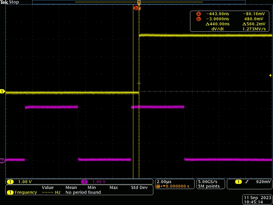

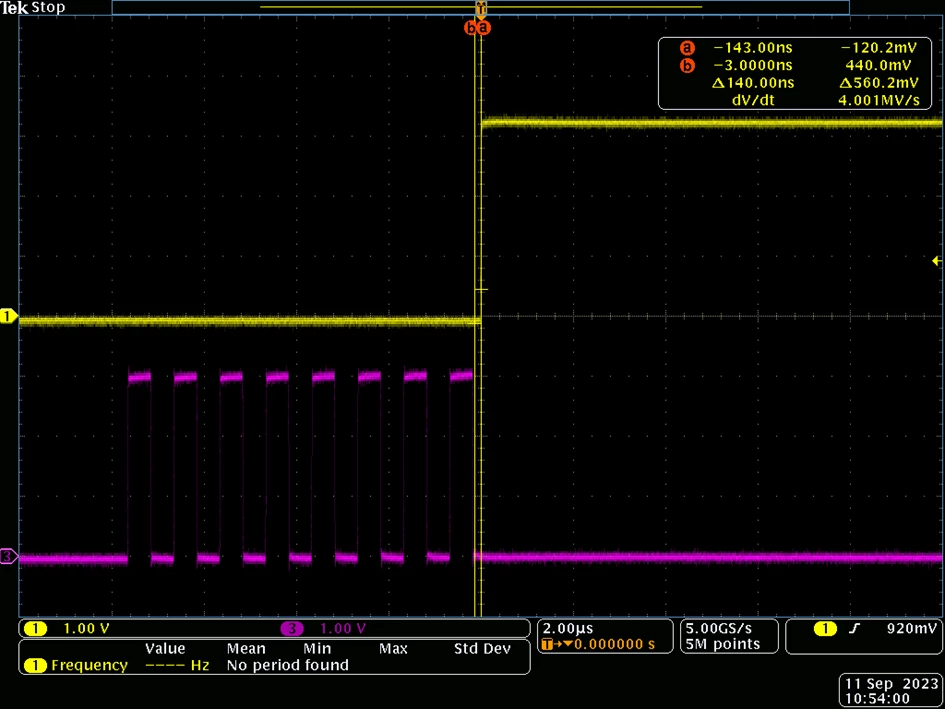

implementing a SPI master (NOT using HAL) with software based SS i am searching for the right way to detect the end of a transmission to release the SS again.
EOT (in SPI_SR) gets set when the last Bit is is set to the MOSI Lane.
--> so this is too early since the there is a full clock cycle remaining until SS should be reset.
Is there any Signal that could be used to know that the Transfer on the SPI BUS is full finished? Using the Hardwaree SS is working fine But since I have a multi-slave environment I would like to use software based SS.

my current workadound is to use EOT as a trigger to release the SS and restrict the minimum speed that can be used on SPI.
YELLOW: NSS
RED: SCLK
125kbit/s (NSS is released too early):
1Mbit/s (NSS is released correctly):

dbahrAuthorBest answer
October 5, 2023
YELLOW: NSS
RED: SCLK
