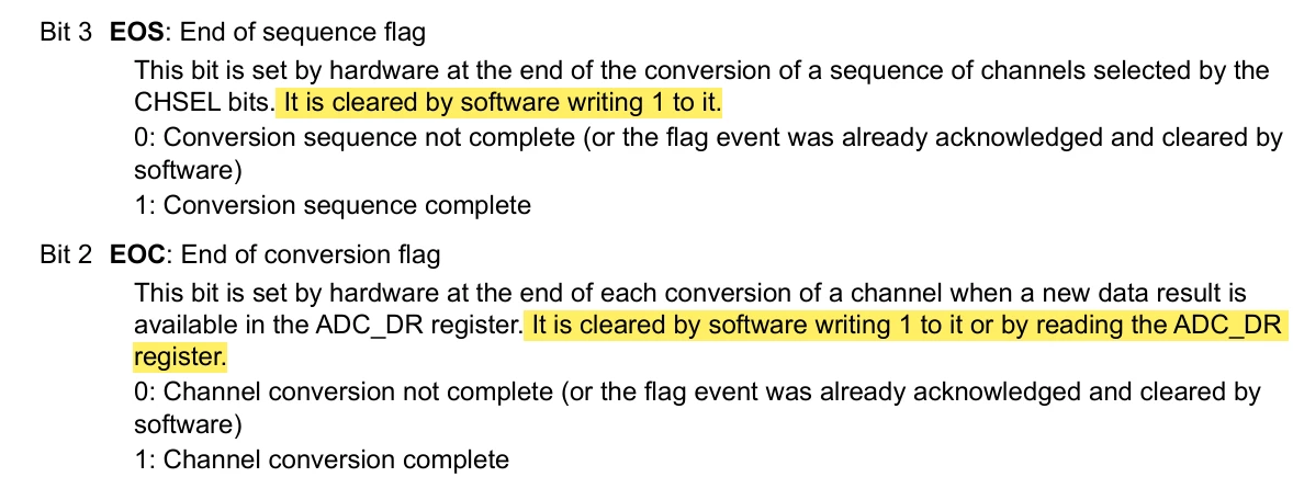

I am having weird behaviour on my STM32G071 MCU.
I set up the ADC to measure in sequence and I want to get an interrupt when the sequence has finished. The ADC is set up with DMA and I am starting conversions manuallty within my loop that runs once a second.
In the interrupt handler I check for EOS and EOC. When I enable the EOS and EOC I get thousands of EOS interrupts in a second and no EOC interrupts.
When I enable the EOC and disable the EOS I get an EOS interrupt for every channel that I have in the sequencer, but no EOC interrupts. It seems like all the channels are measured during the interrupt, but I shouldn't even have these EOS interrupts. Although this kinda works for my application, this still isn't normal.
When I check the regs, the EOCIE is 1 and EOSIE is 0. I also added the reg data as a file. There you can see that the EOS flag is set, but the EOC is not, while EOCIE is set, but EOSIE is not.
My IRQHandler looks like this:
 * @brief Interrupt handler for ADC.
void ADC1_COMP_IRQHandler(void)
 if(ADC1->ISR & ADC_ISR_EOS)
 adc_seq_completed = 1;
 seq_it++;
 ADC1->ISR &= ~ADC_ISR_EOS;
 if(ADC1->ISR & ADC_ISR_EOC)
 conv_it++;
 ADC1->ISR &= ~ADC_ISR_EOC;
 Has anyone else experienced this? What could cause this?
This clears all flags except EOS. If you want to clear EOS:
ADC1->ISR = ADC_ISR_EOS;

Dec 13, 2024 7:06 AM UTC
Oh wow, thank you!
