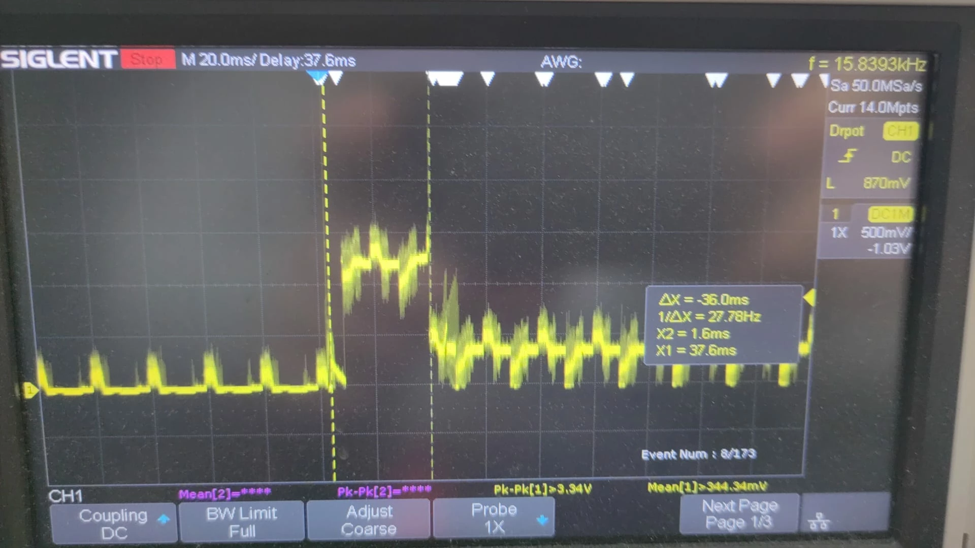

I have this difficult task of powering an STM32G0B1 from a pin that was really not tasked for that (because the connector I have to plug onto provides no supply pin). In short, I can't draw more than 500µA current at any time or I risk lowering the voltage too much for MCU.
I have tried so far to reduce clock and use low power run mode. I get a power consumption around 300µA, which is good enough for me. The problem is that the current drawn at boot before entering low power mode is around 1mA for about 30ms, as you can see on oscilloscope below (1mV=1µA)
Is it possible to start program directly in low power mode without ever entering "normal" mode?

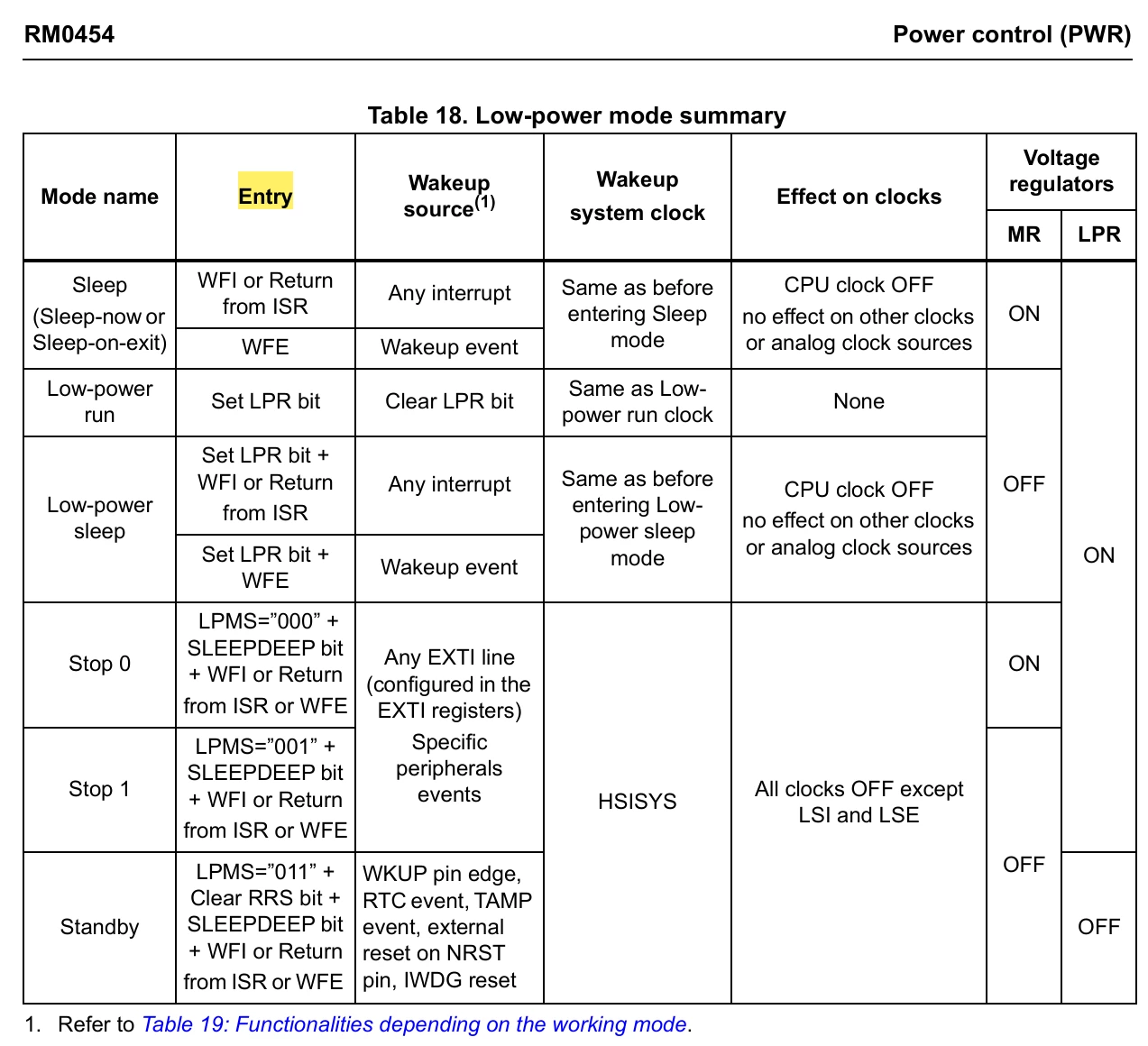

No. Chip always boots to normal mode.
You can see the entry conditions for low power mode here. All of them involve doing something after the chip is in run mode.
You can enter a low power mode immediately (< 1 ms) upon start if you do it right at ResetHandler, though this will involve breaking the normal startup routine that CubeMX uses.

Jan 28, 2025 8:40 PM UTC
Looks like SystemInit is called immediately after startup, so put the clock initialization there or put it in another function and jump to it (bl) before SystemInit.

Hello again,
After some trials, I was able to boot my MCU, thanks in part to larger capas, although I wasn't able to solve the initial 30ms power spike. I believe it is the "reset state" that just takes 30ms, because when I push the reset button, I get the same current consumption and MCU almost immediately goes to low power mode when I release the button/
