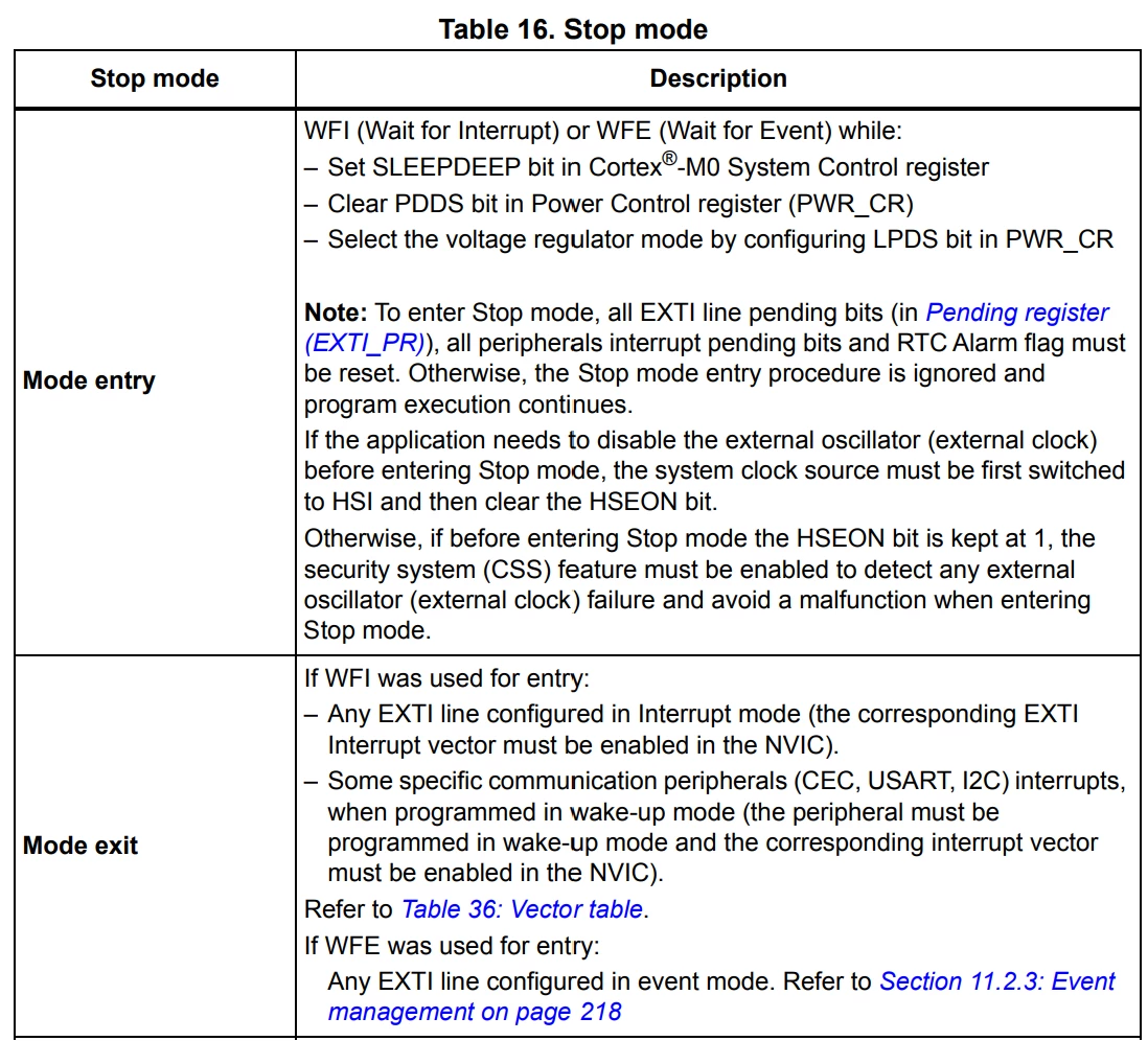

I want to use the STM32F042G6U6 MCU with one button on PA6 pin if I press the button it should toggle between STOP mode and run. Is this possible at all?
How can I do this? I was able to enter STOP mode or exit from it but I cant toggle it in the same interrupt.
And how does exactly this routine works? When exiting from STOP mode what happens, where is the program start from?

You can set up an interrupt on PA6 in your program to go into stop mode, and use the same interrupt to wake it up from stop mode. Note that buttons typically chatter during pressing/releasing and you will need some method of software debouncing.
When the processor wakes up from stop mode, it continues from where it left off.
The reference manual discusses this in detail.
