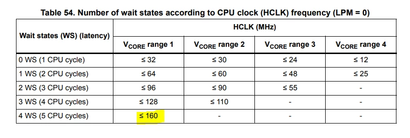

Hello @GG.2, @Tesla DeLorean,
Thank you for bringing this question to my attention!
>>This means that prefetch might be enabled even when there are 0 wait states to access flash memory
This case is not applicable in U5 Flash examples, in fact, all the examples run at 160MHz, according to this frequency, there are 4 wait states (Check RM) :
So prefetch has to be enabled, and PRFTEN must be set since there is more than 1 wait state needed.
I hope this is much more clear.
GG.2
GG.2Author
October 16, 2023
The problem is that I'm running my own code, not the examples, and the HAL should not assume the HCLK frequency... In my case I run at 12MHZ range 4 with 0 WS
