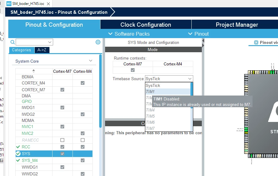

Hey all,
I'm trying to enable FreeRTOS for Nucleo-h745zi-q MCU, but I cannot assign timer to sys clock for cortex-m7 core. It shows timer not assigned to m7 code.

Hello @RevanthManu ,
You need to enable/assign it to CM7 in Timers tab before:
