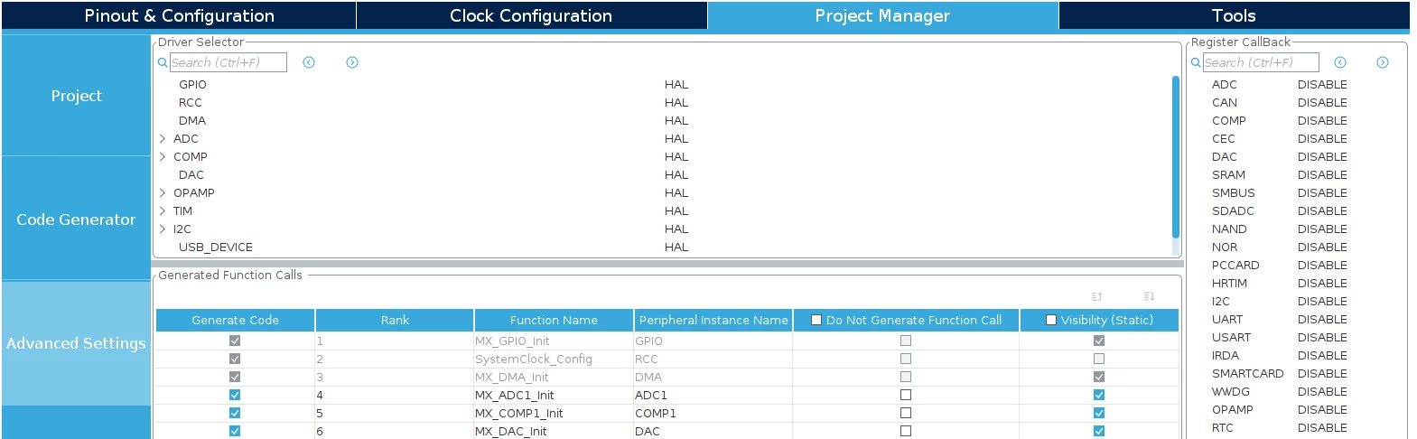

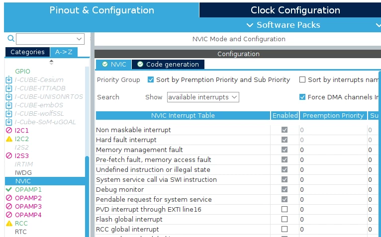

what interrupts are : enable+priority , set in nvic ->
+ callbacks : enable , set in advanced -> right side...
