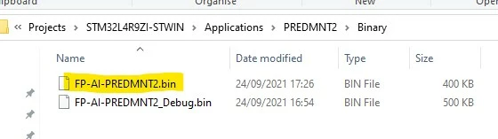

    I programmed the kit using binary precompiled files as on image below.

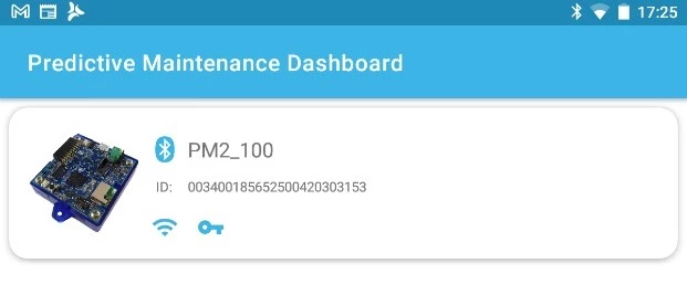

    0693W00000GZpqHQAT.jpgThen, I have configured my kit using ST BLE Sensor (as reported on qs guide above)

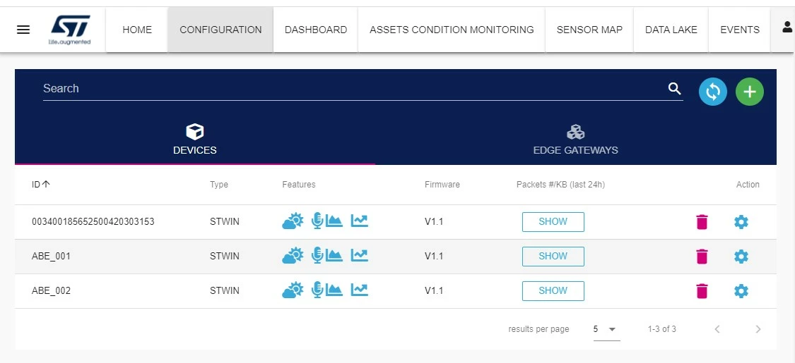

    0693W00000GZpqbQAD.jpgThe kit connects to backend (see WireShark log) and on backend side, this is what I see:
     0693W00000GZpvvQAD.jpgThen I tried to change the telemetry time
    (you can see the communication on WireShark log line 149)
    but nothing happens on Backend
    No data are sent (you can see also the WireShark log after line 149)
