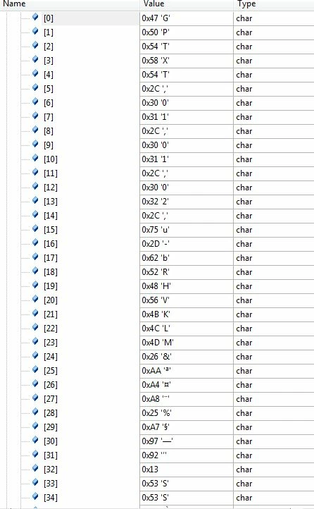

I am using STM32L433RBT6 for receiving data from NEO6M GPS module. The requirement to add the module was given after the circuit board was delivered. Hence, I need to implement the UART reception using emulated uart (bitbanging technique). I have implemented the uart using the technique described below. However, I am getting lots of junk characters mixed up with the target data.
Description:
I have initialized the pin, PB3, as EXTI and am using TIM2 (in update mode, not capture compare) for timing generation. Timer runs at a frequency twice the baud rate. The timing is calculated as follows:
APB clk=72MHz
Baud Rate=9600bps
Timer CNT=72000000/(2*9600) (for twice baud rate, timer count is divided by 2)
Timer CNT=3750=3749 (actual load value)
When EXTI detects a falling edge, it starts the timer by setting the EN bit of the TIM2->CR register whilst serving its ISR. All interrupts are disabled including the PB3 EXTI itself but not the timer interrupt, until the reception of 10 bits (1 stop bit, 1 start bit, 8 bit data, no parity) is over. When the timer generates an interrupt, a counter is incremented in the timer's ISR.
If the interrupt is generated by an odd count, the digital value of the pin is sampled. Else the ISR just checks whether the count has exceeded the frame length i.e. 19 timer counts. In odd counts, the GPIOB->IDR is stored in a buffer variable unprocessed. Once all bits are received. the data is parsed in the main code's infinite loop by masking the corresponding bit in the stored value of GPIOB->IDR. A screenshot of the received, parsed data is attached.
This issue is not board specific. I also tried this code on Nucleo-F767ZI board and found the exact same problem occurring with it too. The reception using a hardware uart is flawless as expected.
I have tried different optimization techniques but to no avail.

This was also my first guess. If you refer the code, all pending interrupt flags are cleared before enabling and after disabling the EXTI. If EXTI is not disabled, its ISR will reset the timer while it is receiving and hence cause the reception to stop.
As can be seen in the the output screenshot, first few characters are received correctly. Junk characters are generated only after good reception of the first few characters, around 15 nos.

Some sample outputs stored on SD card are as follows:
GPRMC,,V,,,,,,,,,,KNKNNITKK''''¥ª*ÒÕS$
GPRMC,V,,,,,,,,,,ªšRbbbbbbb9A,99+30
GPRMC,,V,,,,,,,,,,b‚‚bÊÊrÊÊbbbbbbR¢ÂAMNN64
GPRMC/V,,,,,,,,,,LNNIKK'''§ªÒÕS$
GPRMC,T,,,,,,,,,ªªSÒÕHŠŠŠ‰‰‰‰ÉHø$
GPRMC,,V,,,,,,,,,,KNNNITKK''''¥ª*ÒÕS$
GPRMC,,V,,,,,,,,,,ªš"bbbbbb9A99*30
GPRMC,,V,,,,,,,,,,ªš"bbbbbbb9A9*30
GPRMC,,\,,,,,,,,,,ªš"bbbbbbb9A5e‚RºÊ"bbbb¢þ$
GPRMC,,V,,,,,,,,,b‚‚bÊÊrÊÊbbbbbbR¢ÂªªSÒÕ)HŠŠŠ‰‰‰‰‰ÉHø$
As you can see, the first few characters of the NEMA sentence are good but characters after around 10-15 count are garbage.

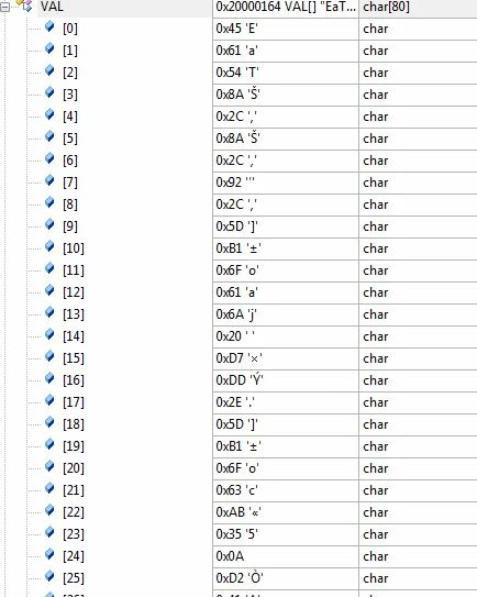

Also, as you suggested, I tried not disabling EXTI. Instead, I introduced an if condition in the EXTI ISR to check if the timer count is 0. If the timer count is zero, i.e. no reception is under progress (timer count is set to zero when all 10 bits are received), and EXTI detects a falling edge (i.e. start bit), timer is started. The output is completely bizarre. And there is no effect of changing the timer update period (even tried doubling, halving etc). Output is attached for your reference. None of the received characters are good.
I tried using two stop bits as you suggested (using hardware UART on NUCLEO-F767ZI board) . Nucleo board sends "HELLO123HELLO$" string. However, my code just receives "HELLO123HELHELLO123HEL...". I double checked my parsing code as well as parsing timing. I inserted a sleep state when the loop is idle. The code does enter sleep state indicating sufficient time for the parsing loop to finish before reception of next character.

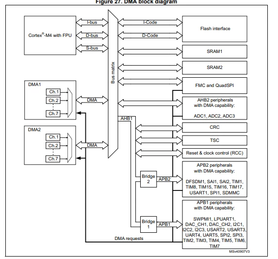

I checked the reference manual. Unlike the F4, the reference manual for STM32L43x is very specific in available bus connection for DMA. GPIO is not listed as one. Could you please check the reference manual and suggest how can I configure my DMA to work with GPIO?
Manual Link: https://www.st.com/resource/en/reference_manual/dm00151940-stm32l41xxx-42xxx-43xxx-44xxx-45xxx-46xxx-advanced-arm-based-32-bit-mcus-stmicroelectronics.pdf

Even in 'L433, PB3 is still TIM2_CH2 so you may/should make use of it as I've outlined above. Read the TIM chapter.
DMA in "L4 *can* access AHB2 thus GPIO.
IMO the most straighforward way is again to abandon early the idea that you pull this out by clicking in CubeMX or writing some magic Cube/HAL incantations. I'm sure it can be done in that way, except it's IMO more laborious than to read the RM (TIM and DMA chapter) and experiment. YMMV.

I had already read the reference manual before posting the question on this forum. Unlike other MCUs from ST lineup this one has very, very specifically defined peripherals having DMA capability on each APB. Refer the attachment.
Also I tried using TIM7 (which is connected to DMA2 CH5), in this case. I could not get the DMA running.
