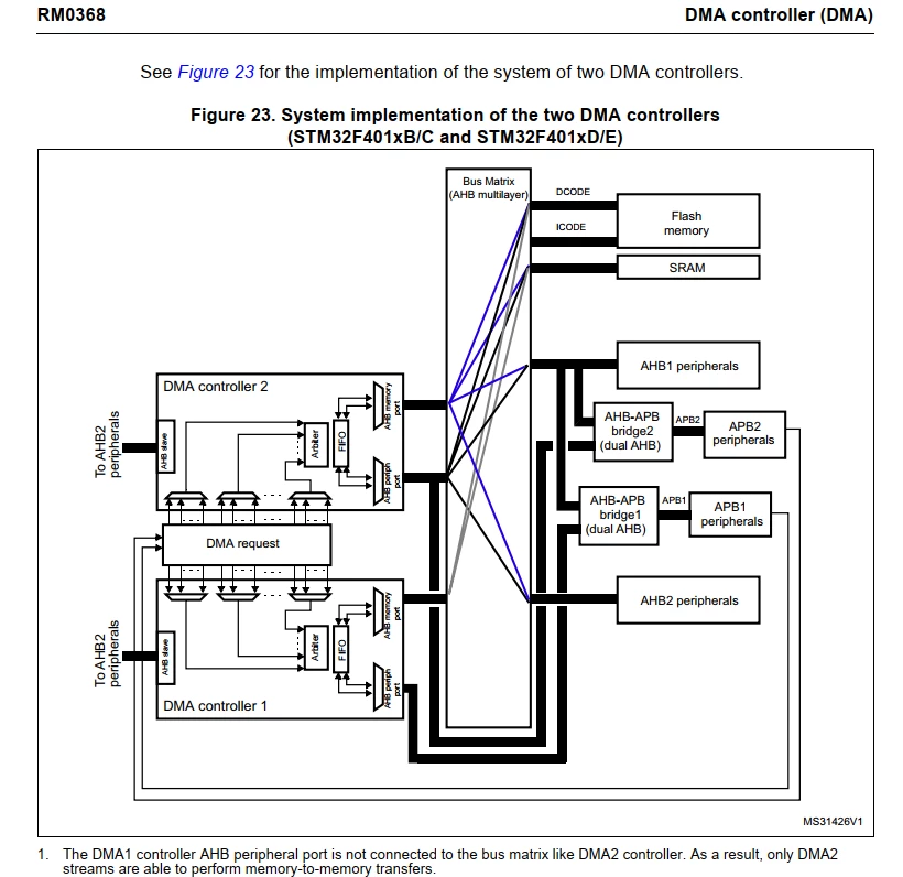

Fig 1 - DMA1 has no connectivity to AHB buses including the one where GPIO sits.
UART Tx can be implemented also in a different way, using a TIMx_CHy pin as output, toggling it using Output compare in Toggle mode with precalculated TIMx_CCRy values, autoloaded by DMA triggered by that same compare. That method can be pulled out using DMA1. It's the same as generating arbitrary waveform with timer - there are examples for that in Cube, and it's described in some appnote (maybe the timer cookbook?).

Yes, you are right.
On figure 23 it is expanded:
Thank you for the tips using Timer Channel + DMA. Not possible for the actual project but for the future it could be a solution.

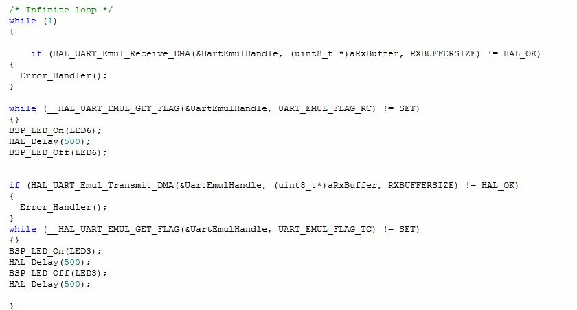

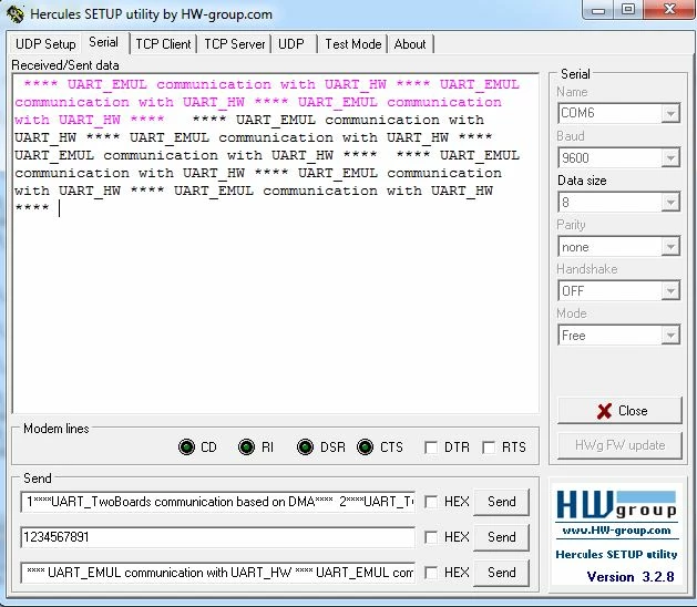

I want make echo serial with uart emulation.
I want receive data from terminal and send it back (echo) with DMA uart emulation.
I was use the AN4457 example code, the issue is when use receiver and transmitter for just once , everything is ok . but put this code in while for continuous echo , stm32 after echo first time will hang.

>>stm32 after echo first time will hang. please guide me for find a solution.
Does it just go to the ErrorHandler() to die there? Perhaps handle the error conditions.
Might want to try a solution that receives data at an individual byte level, and concurrently sends back the byte(s) it has accumulated, rather than this larger buffer ping-pong arrangement you have now.
