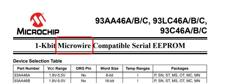

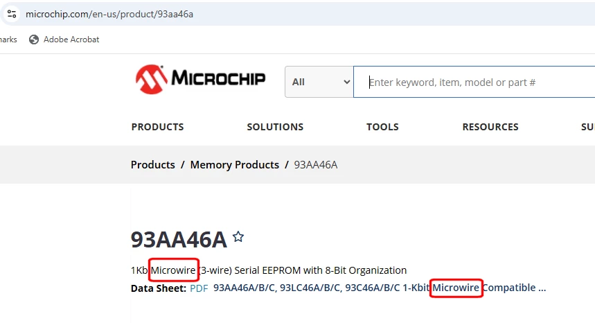

The datasheet I see for the 93AA46A says it's a Microwire device. Microwire is kind of a first-cousin to SPI.
In particular, the request [Ref Table 1-4] is 10 bits, not 8: {1-bit Start, 2-bits Op-code, 7-bits Address}. The Read/Write data is in units of 8-bits. Microwire has no objection to this, but the STM32F105 [Ref RM0008] only supports 8/16-bits, and I don't think I've seen an STM32 where the Rx and Tx frame sizes can be different. (RM0008 also doesn't mention Microwire.)
You may want to consider bit-banging. (There are only 128 bytes, so speed probably isn't a big deal.)

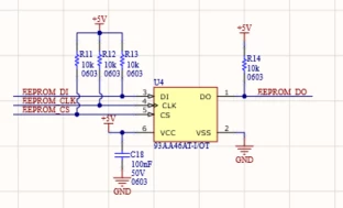

Siva21Author
Feb 19, 2025 12:17 PM UTC
Thank you for your reply.
Here is the diagram:
The supply voltage is wrong and it is 3.3V.
I have also tried without pull-up resistor.
I do have an oscilloscope, and the DO trigger from low to high, when HAL_SPI_Receive or HAL_SPI_TransmitReceive are called.

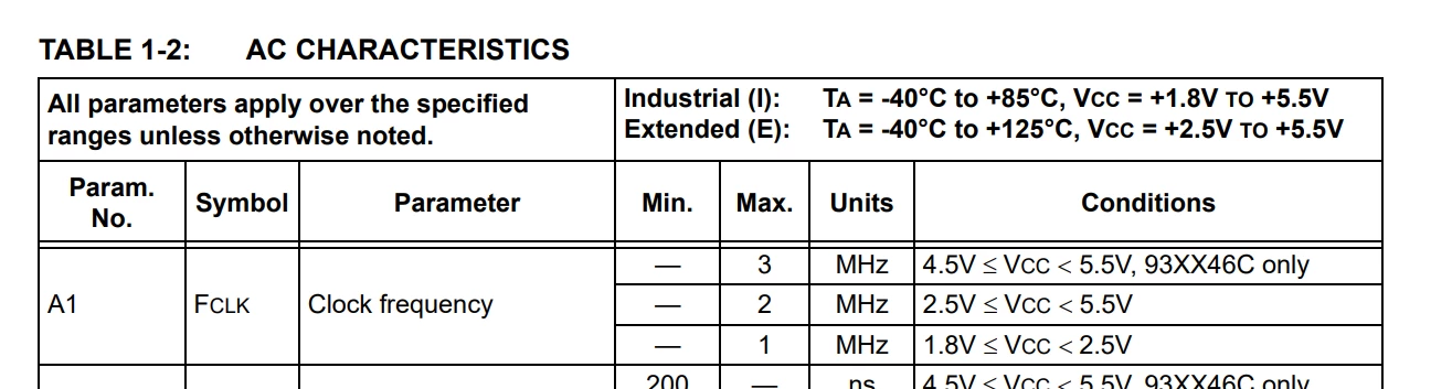

Need to read the datasheet especially the electrical characteristics: SPI frequency, Clock polarity etc .. and configure the SPI accordingly. You need also to probe MOSI/MISO/CLK to debug and understand what is going on to know which part of the communication is not working correctly.
mƎALLEm
Feb 19, 2025 12:53 PM UTC
Start by checking your SPI CLK frequency according the the max clock mentioned in the memory datasheet:

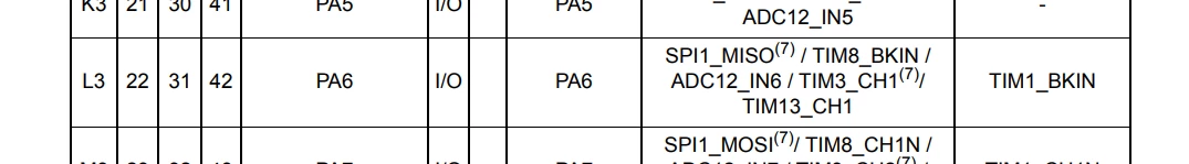

+ You're using F1 family. Some IOs are not Five volt Tolerant (FT). As your memory is powered by 5V, are you sure your are not connecting EEPROM_DO output to one of the non-FT IOs?
Siva21Author
Feb 19, 2025 2:29 PM UTC
The eeprom is powered by 3.3V now. It was a mistake which it is fixed now.

Feb 19, 2025 2:55 PM UTC
You still not answered the question: what is the GPIO used for EEPROM DO? If it was not FT it could be damaged.

Siva21Author
Feb 20, 2025 10:00 AM UTC
Thank you @bmckenney
I have implemented bit-banging for SPI, and it works fine now.
Andrew Neil
Feb 24, 2025 9:18 AM UTC
@Siva21 wrote:
I have implemented bit-banging for SPI (sic)
But @bmckenney's point was that it's not SPI - it's Microwire:
mƎALLEm
Feb 19, 2025 3:03 PM UTC
Unfortunately and according to your schematics, EEPROM DO is connected to PA6 which is not FT IO:
Most probably it was broken while you powered your EEPROM with 5V!
