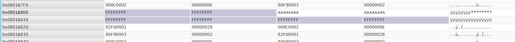

Hi all,
I got one bricked device back from the client and saved both the entire flash and my EEPROM pages.
Attached is the EEPROM export starting from 0x0801b000 to the end of the flash region.
I noticed at 0x081b800 it restarts the headers, or is this a guard page?
I can now inject the hex dump into fresh programmed devices and reproduce the bricking.
I can not reproduce how the EEPROM pages got corrupted, but at least I can now start making code that should be able to repair this.
Can someone here have a look at the file?
Should EE_init be able to handle this?
Another issue I face now is that Debug inside STM32CubeIDE is probably erasing the entire flash?
Because in debug mode everything seems to work again.
It is only when injecting the hex file with STM32CubeProgrammer that I can brick a device.
But I like to verify where it is hanging in the code.
MM..1
Chief III
December 4, 2023
Is right say your brick is jump to errorhandler after EE_Init ?
From hex isnt clear what is fail.
IDE or Programmer can be set to erase full or only required part of flash.
Debug can be started withoud flash erase, set it in debug config.
Trace EE_Init for error source after stored hex dump reflash...
WSpar.1
WSpar.1Author
December 8, 2023
So far not found an option how I can skip programming when start debugging in STM32CubeIDE.
Also an error in EE_init should turn on a red led, that led is never reported turned on.
Could it be NMI / EECD on the G4 series?
It is really difficult to find out what is going on here.

For now I try to collect bricked devices and make full flash dumps of them to figure out what is going on here.
