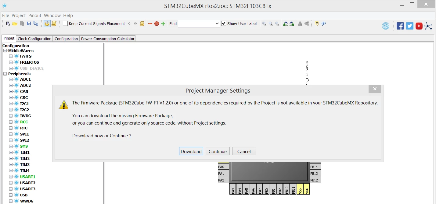

    CubeMX has v1.3.1 of my F1 library so I edited the  ioc file and entered the 1.2.0 to stimulate the CubeMX to use older package and make it download the package:
    ProjectManager.CoupleFile=false
    ProjectManager.CustomerFirmwarePackage=
    ProjectManager.DefaultFWLocation=true
    ProjectManager.DeletePrevious=true
    ProjectManager.DeviceId=STM32F103C8Tx
    ProjectManager.FirmwarePackage=STM32Cube FW_F1 V1.2.0

    Try this trick:
    -generate simple project file using CubeMX
    -close the CumeMX
    -edit the project_name.ioc file, find something like that(this one is for F103): ProjectManager.FirmwarePackage=STM32Cube FW_F1 V1.2.0
    -replace the the number with the one you are looking for
    -start the CubeMX
    -generate code - the CubeMX will complain about lack of the librarry you are using and will download the library
    It worked for me for F103

    Or another idea  - try to guess a path. In my case the path was as follow
    www.st.com/resource/en/firmware2/stm32cube_fw_f1_v120.zip
