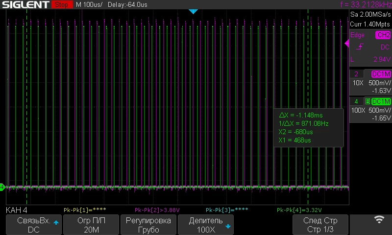

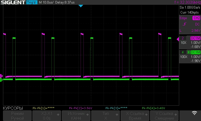

When hardcoded everything works great and I get a phase shift between signals. See the attached image.
But to change it I have to reflash the MCU as I can't get it changed dynamically.

The result is in attached file: roll from oscillator is just an example.
