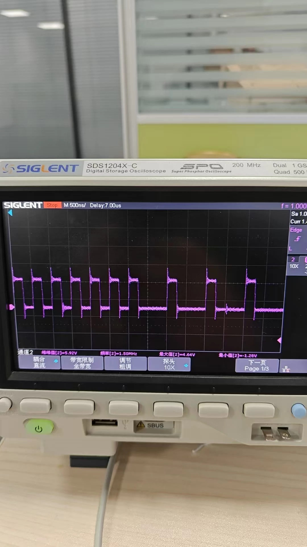

I'm using STM32H743IIT6 with REV_ID=0x2003 and encountered a problem. Quadspi dual-flash indirect read mode is used for continuous reading data from external. According to RM0433, If QUADSPI_DLR = 0xFFFF_FFFF and FSIZE = 0x1F (max value indicating a 4-Gbyte flash memory), then in this special case, transfers continue indefinitely.

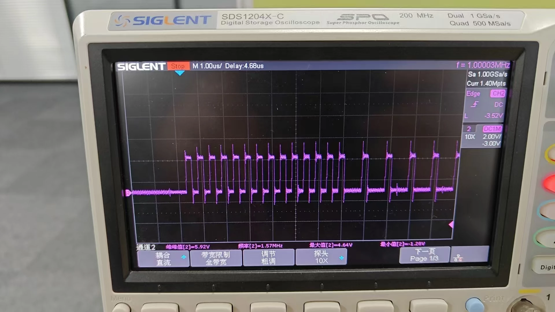

But I found that after the 1st 4GB is transferred, the frequency of QUADSPI CLK pin dropped to it half value, for example from 2MHz to 1MHz, without any error indicator. After that, the 2nd, 3rd and so on, 4GB transfer will remain 1MHz clock operation continuously. Meanwhile, the duty cycle of CLK is changed to 25%, as follows:
I read configuration registers of PRESCALER in QUADSPI_CR and other clock configuration registers after clock frequency dropped, they are not be changed. And the patch of 2.7.4 "QUADSPI internal timing criticality" in ERRATA_DATASHEET has been added.

We just found that the time of frequency change is related to QSPI_AR, when QSPI_AR=0xFFFFFFFE,only 14 cycles of 2MHz CLK is transferred, than it is changed to 1M which duty-cycle of 25%:
14 cycle = 8 cycle address + 4 cycle dummy + 2cycle data

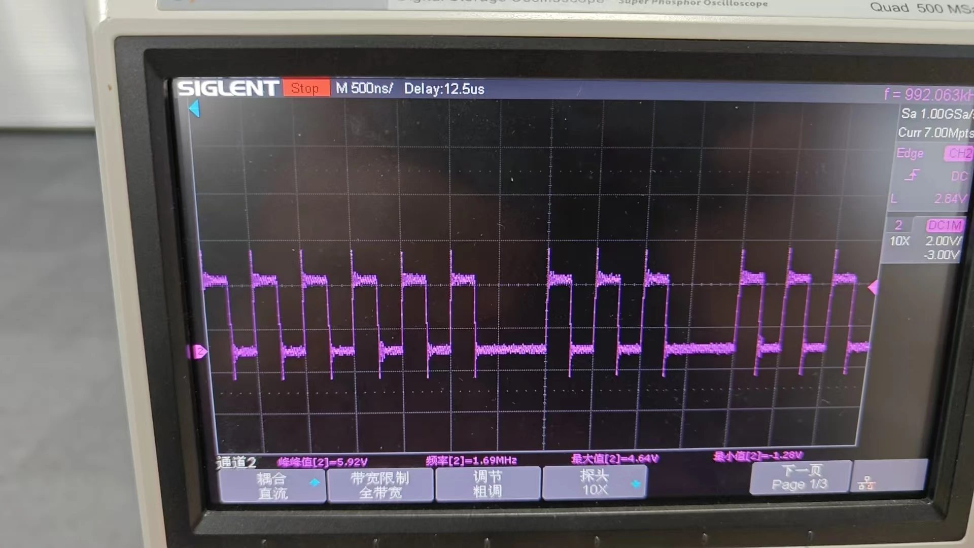

Oct 17, 2025 3:19 AM UTC
in SDR mode, after 4GB transfer, the clock will lack 1 cycle in every 4cycles:
