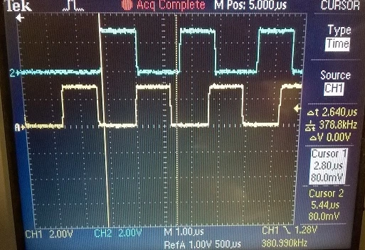

I'm using STM32F303 Discovery board.
I try to evaluate how much code can be performed intimer's IRQHandler without causing desynchronization with PWM of the same timer.

So due to toggling pin inside IRQHandler i saw necessity that time of code performing was less then half of PWM duty cycle. I also try to use CCR2 interrupt but situation is the same. Can somebody explain the reason of such behavior? And maybe it's real somehowachievepossibility to use full time of PWM duty cycle fortimer's IRQHandler? Thank you!

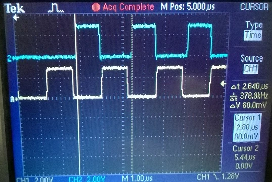

    Thank you, Clive for so fast reply. Try to clarify my problem.
    It's success situation when IRQHandler execution is less than half of PWM duty cycle. As you see software toggling of GPIO in IRQHandler (blue signal) follows toggling of PWM (yellow line) equidistantly (at the same time interval).
    When IRQHandler execution is more than half of PWM duty cycle i saw
    desynchronization
     of my software toggling with PWM toggling. I expected saw it in case when IRQHandler execution time is close to PWM duty cycle but not it half.
    So what the reason of such behavior? And it's possible to chanhe it?

    The processor gets to your IRQHandler when it can, at saturation it is going to directly tail-chain at exit back into the same IRQHandler. The latency is going to depend on how much time/cycles you are sucking up, it is not going to preempt itself. Just prior to saturation it will exit, pop context, and then very soon push context, and come back in. Seem to think that might eat 24 cycles. Joseph Yiu's book probably has a chart.
    The system is going to saturate with interrupts at several 100 KHz.
    Write your handlers more optimally? Doesn't the F3 want you to use CCM RAM? The Flash is very SLOW.

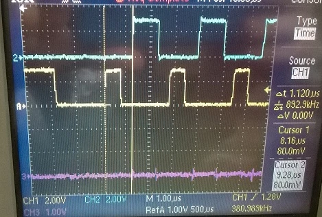

    I understood it but as i said I expected saw that in case when IRQHandler execution time is close to PWM duty cycle but not it half. I have project with clear main loop and one interrupt for timer's update.
    I try to change PWMpulse and understood that i was wrong with moment which corresponds to interrupt handler.
    So problem is latency between PWM toggling (yellow) and software toggling inside interrupt (blue). What caused so big delay?

    Once the interrupt happens, the processor needs to save many registers onto the stack to be able to safely execute your interrupt routine. Even when the memory can be accessed in one cycle, that may take some time.
    It is entirely possible that there is some more processing going on beyond your interrupt handler. I recently had some trouble with an interrupt taking about 8 microseconds beyond my ''toggle the IO pin'' inside my handler......

    So as i understood there is aconsiderable latency between event causing interrupt and its handler. But in this case how to work on frequencies about few MHz? It's interesting info about CCM RAM, will read about it for sure. But how it can be implemented in this case?

    You're going to have to look at the code generated by the compiler to understand where the cycles are going. The context push is 12 cycles. You're not going to be able to interrupt at MHz rates. For that consider using hardware.
