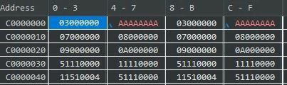

I am using STM32F469 with an external SDRAM (Alliance AS4C16M16MSA-6BIN) through FMC bus. Both STM32F469 and AS4C16M16MSA-6BIN run at 1.8V. The FMC bus is configured with 13 address pins and 16 data pins as follows:

The problem is, when one address is accessed, it always duplicates the operation to another address location. The memory reading is as follows:
I simply wrote 0xAAAAAAA to the location 0xC00000004 and the data in 0xC0000000C updated at the same time.
Any suggestion on this issue? Thanks in advance.

waclawek.jan
February 2, 2021
Sounds like short or bad solder joint on A1 (either memory or STM32), or A1 not configured correctly in GPIO.
Check former by measuring, latter by reading out and checking the respective GPIO registers.

FYI, here was the solution to this issue:
"We ended up by replacing a new SDRAM and resolved the problem, it seems highly likely the fault was caused by a bad soldering on the BGA SDRAM."
Hugues
