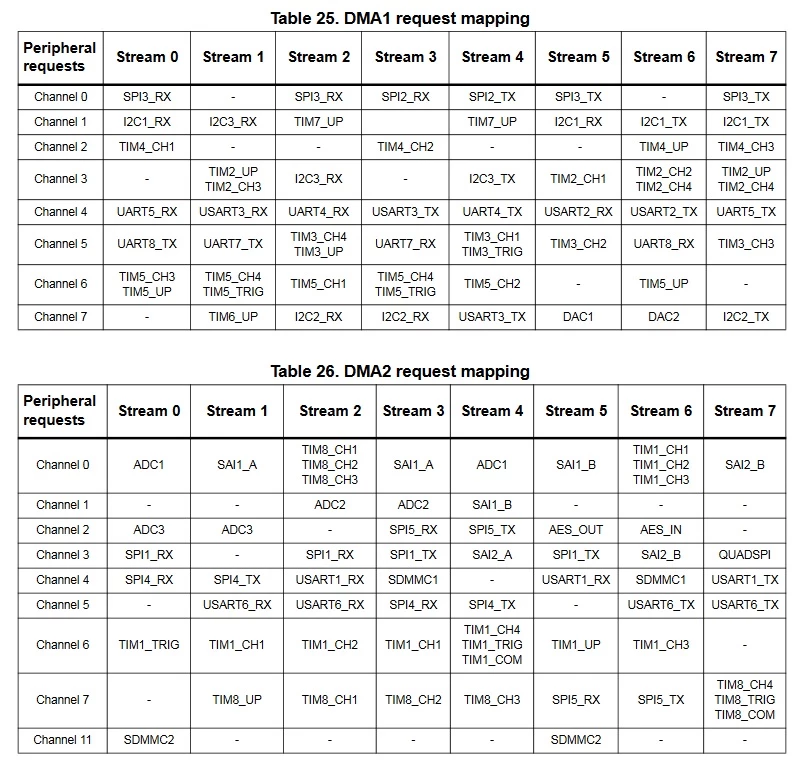

Dual USART DMA configuration issue on STM32F722

    Posted on February 16, 2018 at 23:29
    USART2 will be on DMA1, not DMA2

    David Pekin
    Senior
    Feb 17, 2018 12:05 AM UTC
    Posted on February 17, 2018 at 00:05
    You are the man!!
    I know there had to be that table somewhere.  What document did that come out of?  I looked in the data sheet for the STM32F722 and it's not there.
    Thanks!!!
