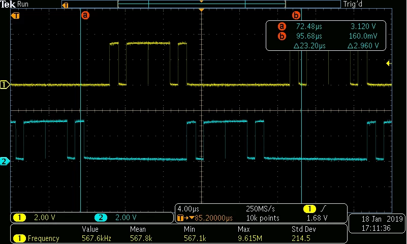

baptor
baptorAuthor
Jan 18, 2019 10:04 AM UTC
Here is the scope image of what I have as output.

Thanks a lot, I got this feature working. The code you provided helped a lot. For those who would like to implement the same feature :
For the timer 1, ( Ch2 and CH3 ) I had to use DMA2 channel 6 stream 5 that is targeting TIM1_UP.
using the function :
 DMABurst_WriteStart(&TimHandle, TIM_DMABASE_ARR,(uint32_t*)aSRC_Buffer, TIM_DMABURSTLENGTH_5TRANSFERS);
I set the dma to write bursts of 5 elements from the ARR register to CCR3.
ARR register is managing PWM period, CCR2 is duty cycle on CH2, CCR3 is duty cycle on CH3.
At update, the DMA is loading one "line" of aSRC_Buffer in ARR  RCR    CCR1   CCR2   CCR3 registers.
/* Capture Compare buffer */                     //ARR   RCR    CCR1   CCR2   CCR3
uint32_t aSRC_Buffer[aSRC_Buffer_ELEMENTS] = {
520, 0x0000, 0x0000,180,0x0000,
                                                 521, 0x0000, 0x0000,180,0x0000,
                                                 520, 0x0000, 0x0000,0x0000,180,
                               //0x0FFF, 0x0001, 0x00FF
I now able to manage duty cycle and period of PWM at each cycle.
