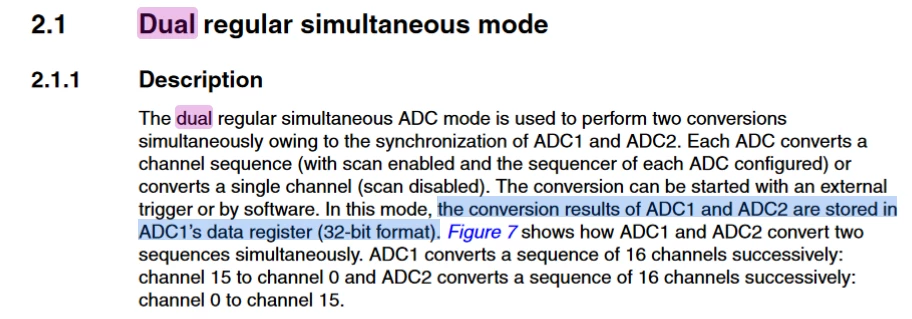

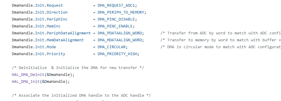

In the mean time, what I found is that there is no dedicated register to gather the 32 bits value that result from ADC1 value + ADC2 value : actually it looks like the concatenation of these two values are actually in ADC1_DR register, as you can read in app note AN3116 § 2. As an exemple in § 2.1.1 :
The code pointed to by @TDK is giving more help (and I fix my original reply here) : It looks like we only need 1 DMA channel to configure, and bound it to the master ADC, aka ADC1 since it looks like (at least in STM32U5 series) you cannot decide who is slave and who is master:
