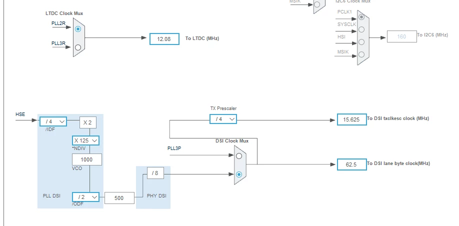

November 15, 2024
The DSI clock should be derived from the clock tree PLL3.PLLP (ck_plldsi) clock for instance to allow a switch-off of the PLL DPHY to save power during the ULPM phase.
You can find more information about the clock configuration in the README.md.
Also, check the timing configuration and the pixel clock configuration from the Datasheet.
Note that the LTCD_CLK must be calculated using the parameters from the display datasheet.

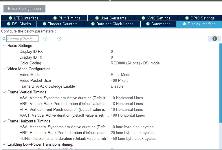

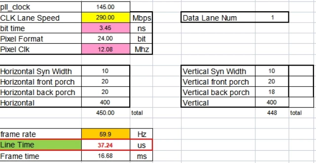

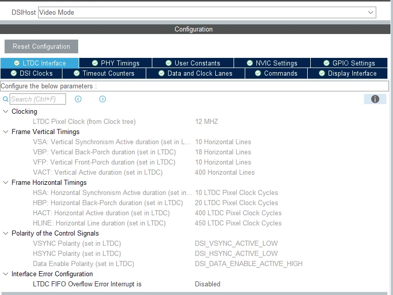

Charlie CHEN
November 15, 2024
Hi @Imen.D
This is my MIPI display timing parameter.
And LTDC Timing setting.
Is there something I missed?
Thanks
