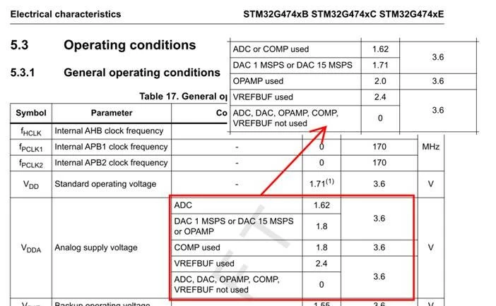

DS12288 Rev 4 - STM32G474 - VDDA min mismatch for Opamp between Table 17 and Table 80
Section 5.3.1, Page 85, Table 17 has VDDA min for OPAMP as 1.8V
Section 5.3.23, Page 166, Table 80 has VDDA min for OPAMP as 2V
Which is the correct value?
I really hope it is 1.8V because that is what all my circuits are designed for...

Hello @Singh.Harjit​ ,
Thank you again for bringing this typo to our attention.
There is mistake in STM32G474 datasheet in Table 17.
Here is correction from STM32G431 datasheet:
I raised your feedback internally to correct the value in the coming release of this datasheet (as we just now released a new version ☹ that will be published soon).

Hello @Singh.Harjit ,
Fix available in DS12288 Rev 6.
Thanks for your contribution.
