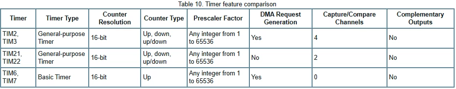

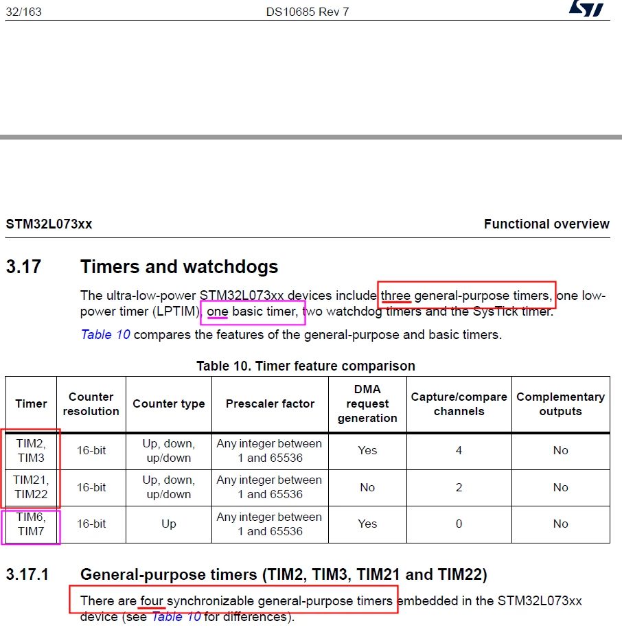

I have the confirmation that the introduction has a typo and it should be:
The ultra-low-power STM32L073xx devices include four general-purpose timers, one low-power timer (LPTIM), two basic timers, two watchdog timers, and the SysTick timer. Table 10 compares the features of the general-purpose and basic timers.
We may also update the table to add another column for timer type as the following:
Hope that helps.

Hello ​@Andrew Neil,
Will escalate internally for analysis. Internal ticket number CDM0066117.
I’ll get back to you for any feedback.
Thank you for your contribution.

mƎALLEmBest answer
Sep 29, 2026 4:12 PM UTC
Hope that helps.
