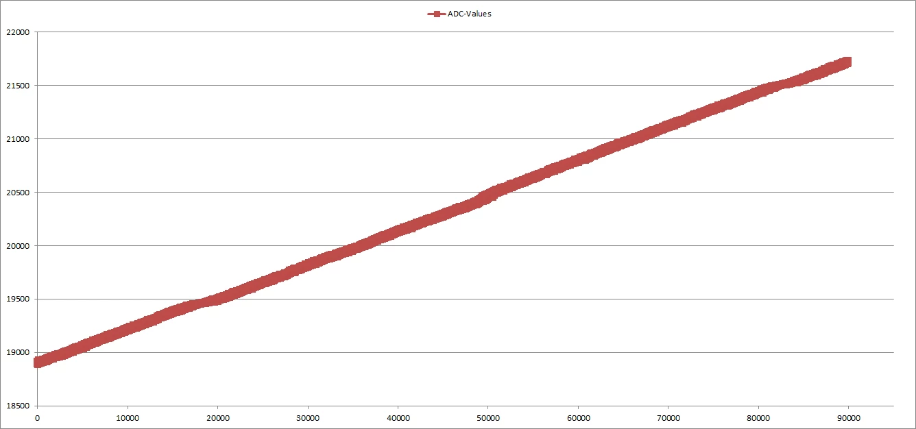

Dropouts in ADC capture on STM32H743
If I connect a constant rising signal at the ADC input, I observe significant fluctuations at certain ADC values. These fluctuations always appear at the same ADC values. The affected values have the following format XX500, e.g. 18500, 19500, 20500 etc.
I was also able to reproduce this behavior with the NUCLEO-H743ZI and the example projects (ADC_DMA_Transfer and ADC_RegularConversion_Polling) from the current cube firmware V1.5.0. The graphic in the appendix shows a recorded ADC values, which shows the problem.
Can someone help me to solve the problem?

RevV is the latest version. The ADC on RevY had too many problems, and was significantly changed. As you can read in the note I linked to, it talks about "migration from RevY to RevV". The currently manufactured chip is RevV. The errata document also lists all 3 revisions (Y, X and V), and you can see that the V version is the newer one, with the fewer problems https://www.st.com/content/ccc/resource/technical/document/errata_sheet/group0/b8/f4/b7/a3/d1/a0/44/a6/DM00368411/files/DM00368411.pdf/jcr:content/translations/en.DM00368411.pdf. The X revision seems to have been an engineering sample only, superseded by the V at the time of release
And, yes, the new HAL takes differences into account, even if I personally avoid using the HAL as much as possible, so I haven't looked into its specifics. But, still, if you have a RevY chip, your ADC will not perform as well as a RevV chip.
I have no idea if your problem is a specific RevY problem, but after reading a lot of posts with ADC issues on STM32H7, I realized that there were a lot of unexplained issues, pretty much all on RevY. So personally I would not spend too much time on addressing ADC issues on RevY, and get a RevV chip instead for anything where ADC performance is critical

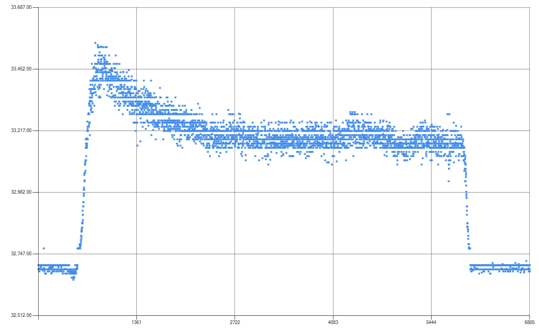

I am using an H750RevV with HalV1.9. I am seeing these issues on both ADC1 and ADC3. It is definitely related to a calibration issue, but that is not the only factor. Depending on which microcontroller we are testing, we will see anywhere from 0 gapping to ~150 ADC count gaps (this is 16 bit ADC). We were able to replicate this on evaluation kits as well. There are regions in the digital output that are just jumped over (ie offset).
We switched from ADC_CALIB_OFFSET to ADC_CALIB_OFFSET_LINEARITY which solved the problem on most devices but not all.
We are still seeing this issue, is there anyone who has absolutely eradicated this?
