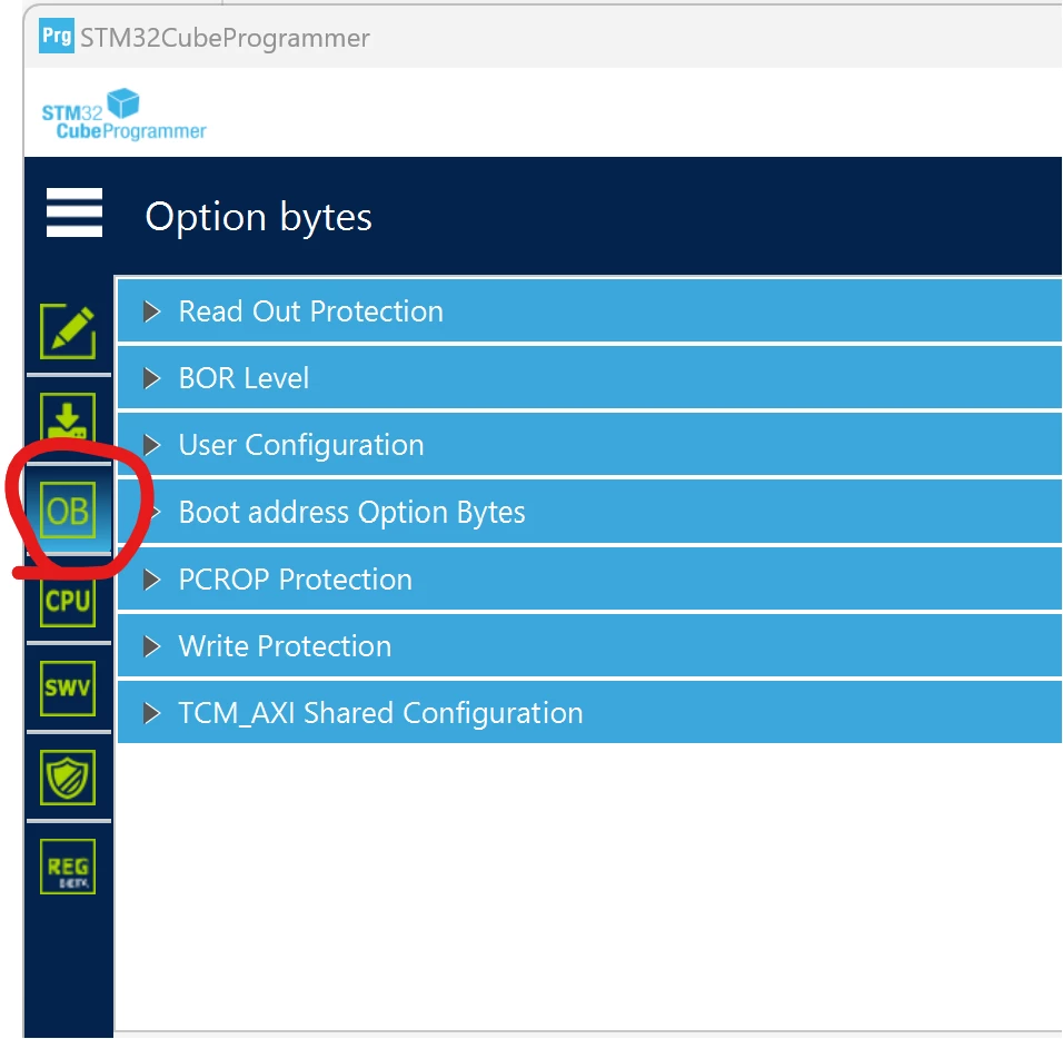

Downloaded STM32H7A3 program runs but doesn't stay flashed
I'm bringing up a new board using a STM32H7A3. I've developed, downloaded, debugged and run lots of test programs from the VisualGDB IDE.  Now I'm working on the main application. I can still develop, download, debug and run from VisualGDB but when I exit VisualGDB, power down the board and repower it, the program doesn't seem to start up.  Almost the very first thing the main app does is blink a LED and that's not happening after powering down and powering back up. VisualGDB has a simple HAL based Blinky example built in and as a test, I built this example and it works fine both from VGDB and after powering down and back up.
If I set a break point at the first line of code in my main app and look at the disassembled code, it starts running at memory location 0x08020DF8.  The Blinky app starts at 0X08000348.  Both of those memory locations are in the Flash memory space according to the reference manual so I'm pretty sure both programs are running from Flash memory.
I'm using a STLinkV3-PWR debugger for both programs.
Another hint is I can download the Blinky program .bin fileusing CubeProgrammer and it runs fine after power down/up.  But If I try to download my main app .bin file with CubeProgrammer, it doesn't run at all.
Seems like I need to set some bit somewhere before the download process to make sure the main app gets permanently programmed.  Or maybe there's a bit I have to set so the Flash doesn't get cleared on power up.  I've scoured the reference manual but haven't found anything helpful yet.
Any help will be greatly appreciated as always. - Thanks

Okay, getting somewhere. Option bytes seem okay.
I would suggest seeing where the code is when it's frozen after a power reset. Probably it is waiting for LSE to come up (or HSE but more likely LSE). To do so:
  • In debug configuration, Startup -> Load Image and Symbols -> Download -> False
  • In debug configuration, Debugger -> Reset Behavior -> None
Keep your debugger connected, power cycle your board. It should "hang" as you describe. Now launch the debug configuration and hit pause. It will show where the program execution is currently at.
If those are the problem perhaps recheck your design for valid crystals and load caps. Try lower/higher cap values and/or higher drive settings.

Flash doesn't spontaneously erase itself, there's no flag or mechanism for that. Are you sure the program is actually gone? Connect with STM32CubeProgrammer and verify that the program is gone.

> Is there something I can do to make sure the target is not waiting for a debugger to do something when no debugger is connected?
After a power cycle, the cpu is running code either in FLASH or RAM according to various BOOT pin states and option bytes (see AN2606 for details). There is no flag to say "wait until a debugger is present before running."
What could be happening is your BOOT pins or option bytes are causing the cpu to jump to the system bootloader, or some other code which isn't what you're expecting. In STM32CubeIDE you can debug a chip without resetting it to see what code it's running. Your IDE may have something similar. Typically the user code in FLASH at 0x08000000 is run.
Is this a custom board? Is BOOT0 grounded?
When you debug code, the debugger explicitly sets the starting address, so it will start at the correct location regardless of BOOT pin and option byte settings.

@TDK OK, that helps a lot.  This is a custom board.  I have a jumper on BOOT0 so I can pull it high or low but it is currently grounded through a 10K resistor. By option bytes, I'm assuming you mean the Flash registers, right?
I'm going through the Flash registers bit by bit to see if I can find anything that looks wrong or even questionable.  There area lot of registers and a lot of bits, so it will take me a while.  In addition, I have a whole bunch of test programs that work on a Nucleo-H7A3ZI-Q board and will start properly after power cycling so I can compare the Flash registers on the Nucleo with my custom board registers.
As always, thanks a tonne for your quick and informative replies.
January 23, 2024
I mean option bytes. They are flash registers but so are a lot of other things. Connect with STM32CubeProgrammer and click the OB icon. There are only a few relevant ones.
