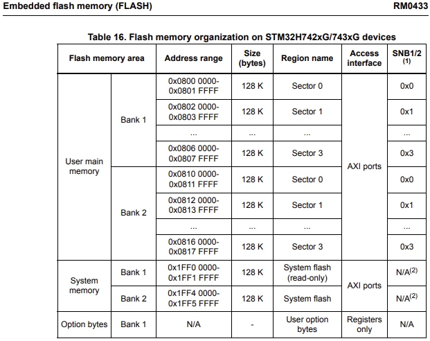

I use STM32CubeIDE 1.16.0 to do project and use STM32H743.when my code is over 512K, I re-write ld file,but download is failed.
But I use STM32CubeProgrammer to download  the same elf file,it worked!!!
So what's wrong about it ?

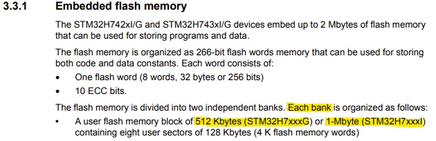

@SDFSDFDSF What is the exact STM32H743 part number?
STM32H743VGxx officially has a hole after 512KB, between bank1 and bank2. But! The hole does not have to exist. This can explain why CubeProgrammer and the debugger behave differently. Officially, your .ld file that does not have the gap after 512KB is wrong for H743xG.

So,what I can do when my code size is over 512K?
Pavel A.
August 6, 2024
Divide it to two blocks: 512K in bank1, and 512K in bank2.  You can also use the undocumented space in the gap between the banks, on your own risk.

Why FLASH2 start address is 0x08100000?
0x08000000 ~ 0x08100000 is 1024kbytes.
Pavel A.
August 7, 2024
>> FLASH | FLASH2
This isn't valid syntax.
To use the FLASH2 you may need to analyze the map file and distribute the source modules between FLASH1 and FLASH2. The ld file will be more complicated, unfortunately. Maybe if you define a single FLASH of 1.5MB, and put a section of 512K at absolute address 0x8080000 before defining other normal sections, it could work too. I haven't tried this for GNU linker.
Or just define all RAM as non-executabe ("rw") and both flash regions as "rx", and remove from .ld file definition of all sections that should go to flash. Then the linker could automatically place stuff.
