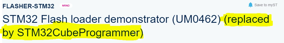

Hello @Lkim.1​ ,
Flash Loader Demonstrator is deprecated and isn't guaranteed to work on newer parts.
0693W00000BdOdiQAF.pngPlease check section 2.1.4, figure 7 for the steps you need to follow in STM32CubeProgrammer's user manual: https://www.st.com/resource/en/user_manual/um2237-stm32cubeprogrammer-software-description-stmicroelectronics.pdf
