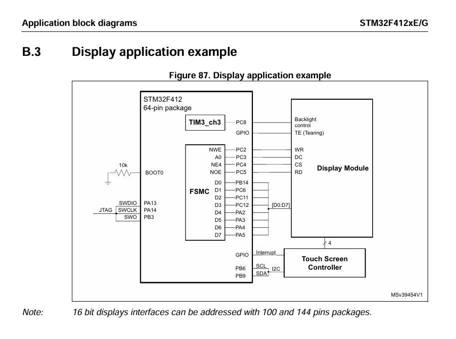

Currently, I am using the STM32F412RGT6 64-pin package to drive an 8-bit MCU interface screen. However, I am unsure if this MCU supports FSMC.

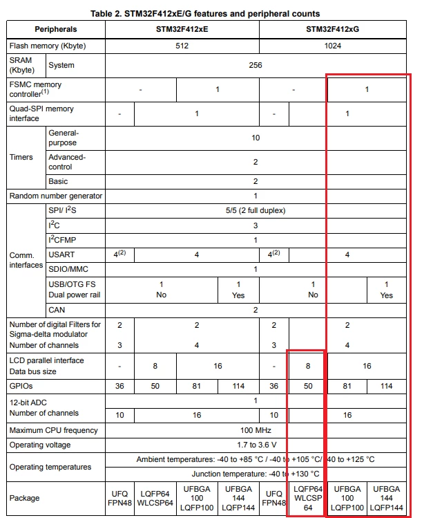

What stm32f412 datasheet says?:
The answer is yes for UFBGA 100 and LQFP100 packages.
For LQFP64 and WLCSP 64 packages you can use LCD interface for 8-bit data bus.

AA4Author
Jun 23, 2026 12:35 AM UTC
I found an application example in the data sheet of STM32F412RGT6. I followed this example to apply it. Is there any problem with this approach?
AA4Author
Jun 23, 2026 1:02 AM UTC
May I understand it this way? In the 64-pin package of the STM32F412RGT6 chip, there is indeed an FSMC (Flexible Serial Memory Controller), and this function has not been disabled. However, due to the limitations of the package, the complete set of FSMC pins have not been exposed, only an address pin has been driven. Since this is sufficient to control the display, it is referred to as an LCD interface.
mƎALLEm
mƎALLEmBest answer
Jun 23, 2026 7:56 AM UTC
Indeed and with LQFP64 only 8-bit (or less) LCD can be driven and indeed that figure is the correct way to connect the LCD to FSMC.
