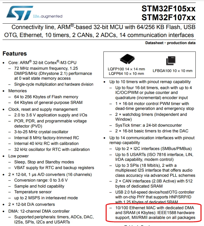

@Guillaume K wrote:
Gigabit Ethernet ? No, I think it can do only 10/100 Mbit.
Indeed:
Andrew Neil
Andrew NeilBest answer
August 21, 2024
Indeed:
mƎALLEm
August 21, 2024
No Gigabit Ethernet interface on STM32F107RBT6. Look at STM32MP family.
